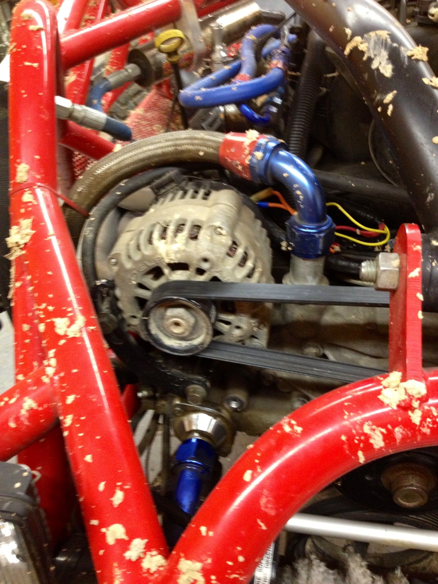

That's what I had to run on mine an fittings don't even compare to the price of the hose think it was right at 350 for hose but I have no problems with it got a 6.0 with dual pass rad running 4500 cfm fans she never gets over 210 while beating the **** out of it
This is how I plumbed into water pump
Thats how I want mine. Looks good
