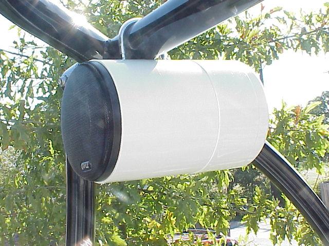

Doin some research for some audio options in the taco and came across these..
seems like a good idea on the cheap
6in pvc
couplers
end caps
couple Home depot u bolts..
fits 6.5 in speakeers
Im probably going to coat mine with rubberized undercoating to cut down vibrations...
Skimp on terminals, just run the wires straight out the bottom w/ some silicone around them...
marine speakers

what is the deal or where can i get some of thosw liitle guy amps?
also i figure the pvc caps are to cap one end off but what are the pvc couplers for?
and how long do they need to be to sound right and do they need any of that polyfill stuff inside?
alot of my buddies have used this idea on there boats to save on the exspensive tower speakers.....good idea that works really well !!!!!!! :spin:
Not shure, but
on the amp you can get one designed for a motorcyle. Hog tunes sales one
on the coupler thingy it looks like the 6" pipe is just slid indside to screw the speaker to. When you put the cover on the speaker it is bigger that the speaker and probably looks bad. Put the coupler on and it looks smooth.
on the tower speaker you buy they are around 8" to 12" inches and I would think you could rock out without any filler. I have Memphis speakers in my boat with no padding or anything and they are loud enough for me to here over straight exhaust.

and on the amp, most run a cheap one from ebay.. not sure the name..
google "homemade 4wheeler speaker tube" or somethin like that.. its the atv guys that run the amps inside their box setups...
the end cap is to cap one end and the coupler gives it a clean look and makes it flush w/ the 6.5 speakers...
