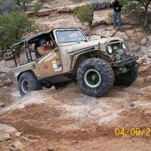

Here's the old Rubicon before she was parted out.. had some good times in that rig and learned alot about wheeling, second pic was with my nephew Austin in Tellico before it closed

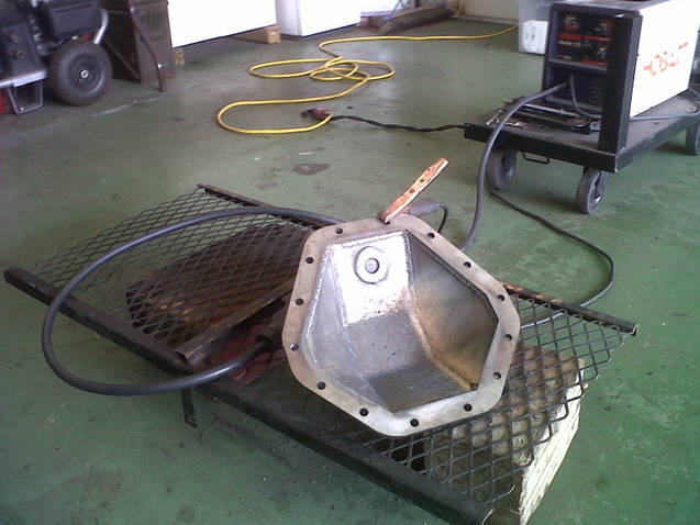

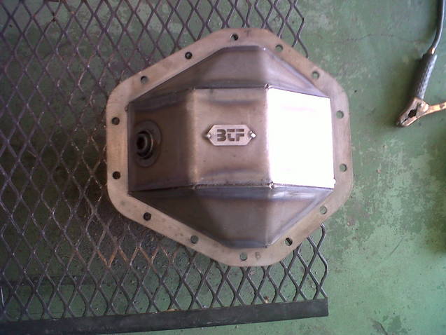

First "project" in order was to weld up the rear 14 bolt diff cover from blue torch. It was 4 seperate pieces and I welded it inside and out.
