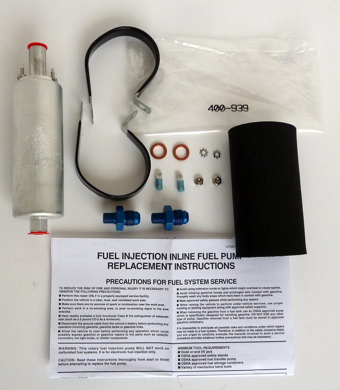

I run the Walbro GSL392 with a Russell Fuel Filter after the pump. Pump needs to be as close to the tank as possible as they don't like sucking. Keep the lizards out for a trouble free system.

I get these off eBay.
http://www.ebay.com/itm/WALBRO-255LPH-EXTERNAL-INLINE-FUEL-PUMP-GSL-392-GSL392-/290842863523?pt=Motors_Car_Truck_Parts_Accessories&hash=item43b795e7a3&vxp=mtr
I run the pump with the 6AN fittings:
http://www.ebay.com/itm/Walbro-GSL392-6AN-KIT-255-LPH-HP-Fuel-Pump-External-GSL392-Complete-/170920041585?pt=Motors_Car_Truck_Parts_Accessories&hash=item27cba0dc71&vxp=mtr
I'm running the same Walbro pump john linked above, mounted 6" away from tank and 2" lower from a sumped tank, no issues in a full season of riding.
