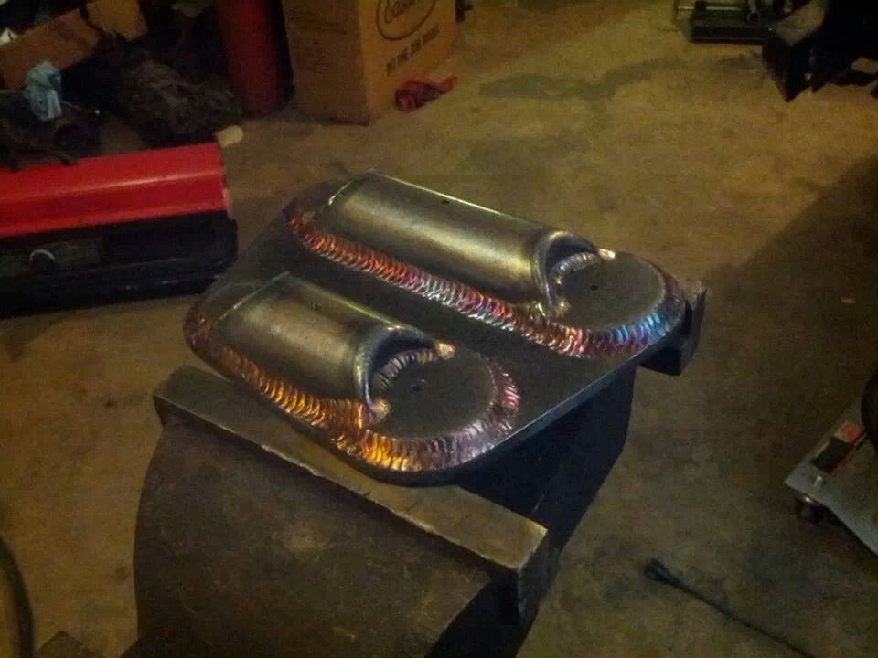

A wild series of events, has led to the beginning of Dynamite Design. The last few years you would more than likely find me mowing yards, or sitting in the house sketching random things on paper.
A man named Josh Twomey contacted me, out of the blue a few months ago. He needed some shock tuning done on his rig. We met and did the tune. After this event, Josh basically took it upon himself to fill my garage with more than enough fabrication equipment, to start a business.
PJ at M&M did the suspension work on this rig not long ago. Josh has done a lot of work on it himself. I am going to do some finish work on it, and hopefully prove Josh's faith in me.
I called this thread "Sling Shot" because just a few months ago, all I had to work with was a $100 flux core welder and a grinder.... Game on....

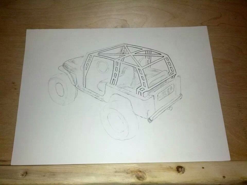

Working on something like this right now /first.

2. David's task are to build a new Baller ass cage, a new dash, and a new fuel cell. That way I can have my rear seat in and also have some storage area.

C pillar mounts.... at first I thought they were shackles
