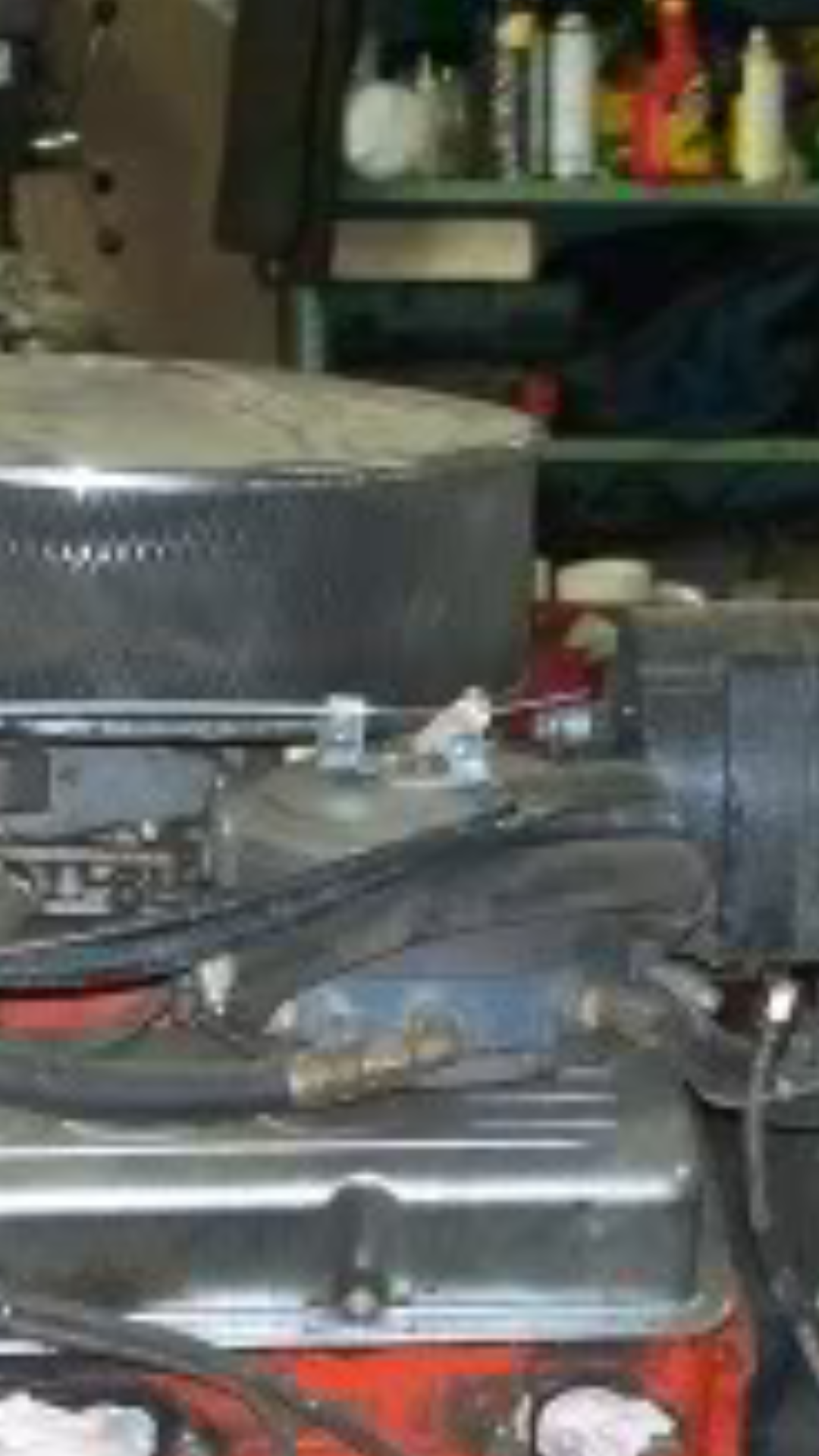

Could there be something wrong with the vaporizer since holding that button down will make it crank?? I have no idea as to exactly how they work to imagine what could be wrong with it internally. There's a holethat's threaded on the front side of the vaporizer and when I push that button, it makes a brief spewing sound and you can see something inside it move up and virtually close off that hole...should that hole be open like that? Maybe something was there before and vibrated out?

See pics below for the little hole on the top-front of the vaporizer that's open and also the missing filter on the valve cover...

The large pipe coming out of the front of the vaporizer going to the mixer Get it running then spray brake parts cleaner around the carb base and all of the mixer and the vaporizer and see if anywhere makes it run better or die
Plug that hole in the valve cover and the vaporizer first. All the button does like mentioned above is provide a shot of propane to help starting. Also like mentioned above, you have to have good vacuum to the lock off to get it to open so propane will flow to the vaporizer. Try sucking on the vacuum line going to the lock off a few times and then try cranking it. If it starts, lock off is working and the vacuum line or its source is causing the problem. You can get parts to rebuild any part of the system from any forklift repair shop or the guy in B'ham who is on here some that sells propane stuff.
