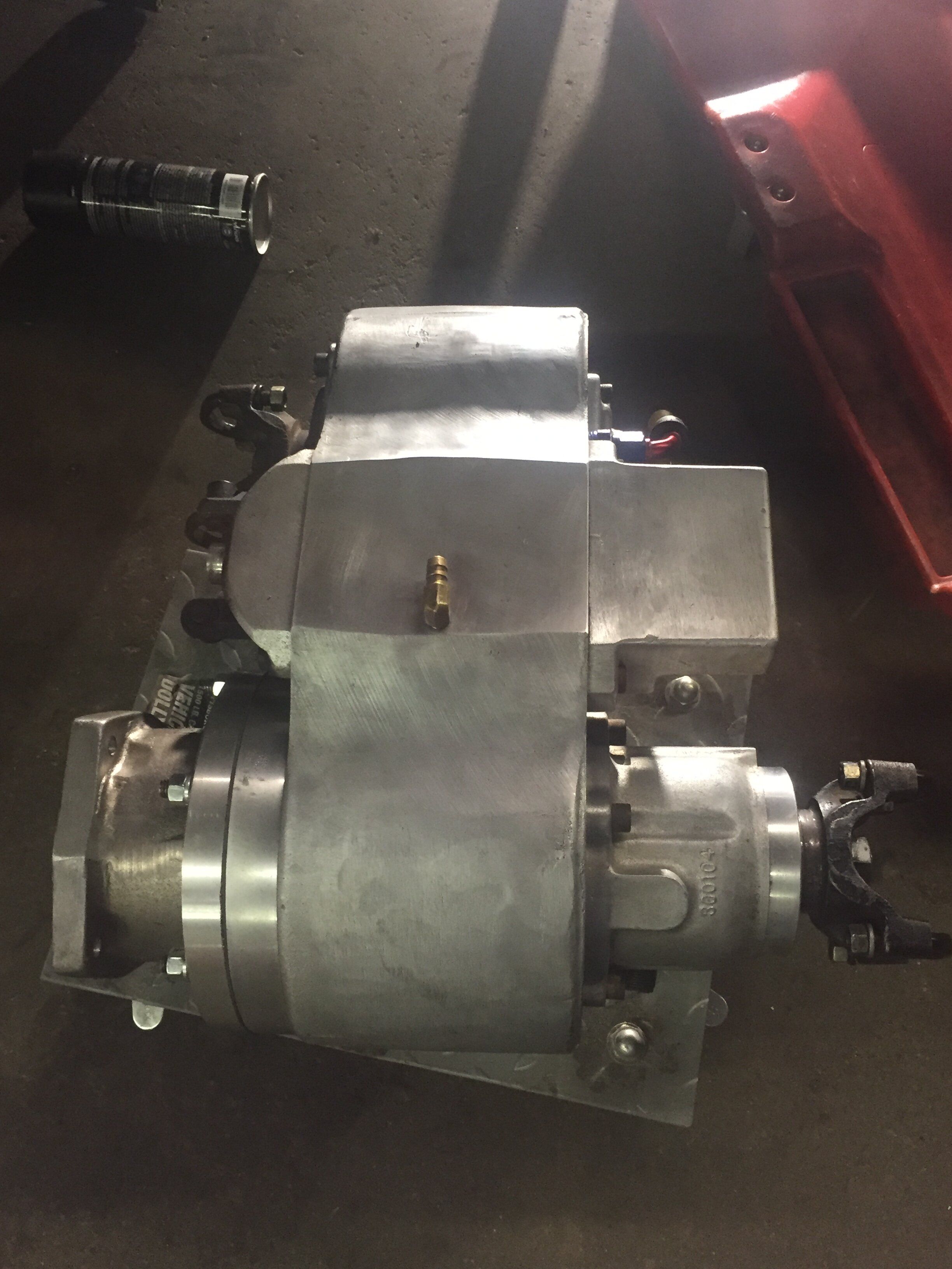

As soon as you think fa Work is done there is something else!
I was able to get a few things done this week but had a slight set back and had to pull the trans and transfer case to put a longer adapter in for drive shaft clearance.

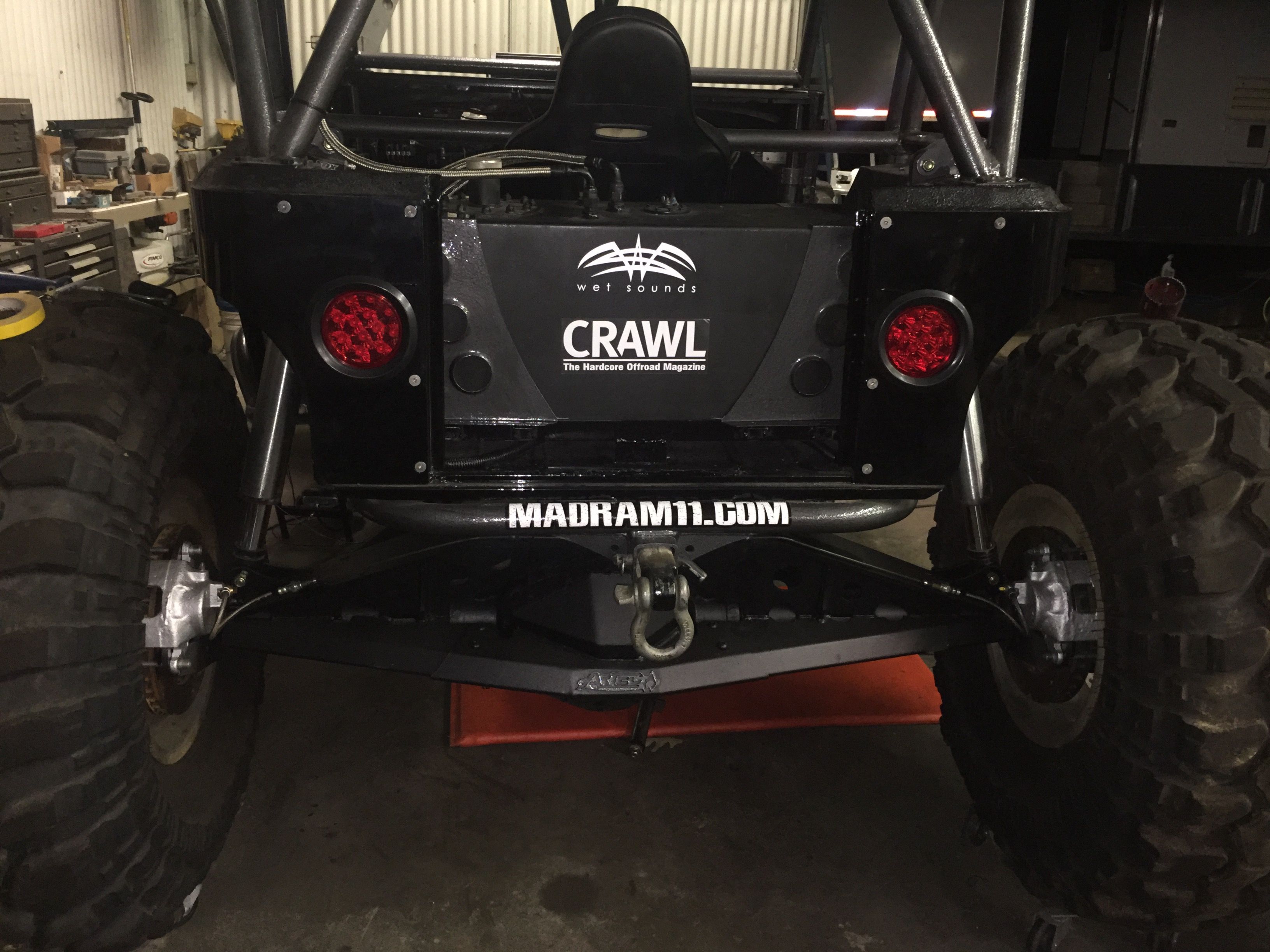

Well finally got the wiring done and dash installed. I need to extend my oil pressure sending unit plug and change all of the fluids and it should be able to see if she will fire up!
Re: CJ7 Juggy €œTrail Rated€
yeager_0339 said:
For a little bit! I'm sure these guys I ride with will pick the tightest nasty trail first ride!
Why would we do that? :dunno:
You need to show this art work off at EJS coming up. Very nice and neat job :dblthumb:
Thanks man! I highly doubt mine would show off anything compared to some of the rigs out there. But I have always wanted to go out there!
Where did you source your rock lights? What is the wattage?
Your rig looks great by the way! I like the attention to detail.
