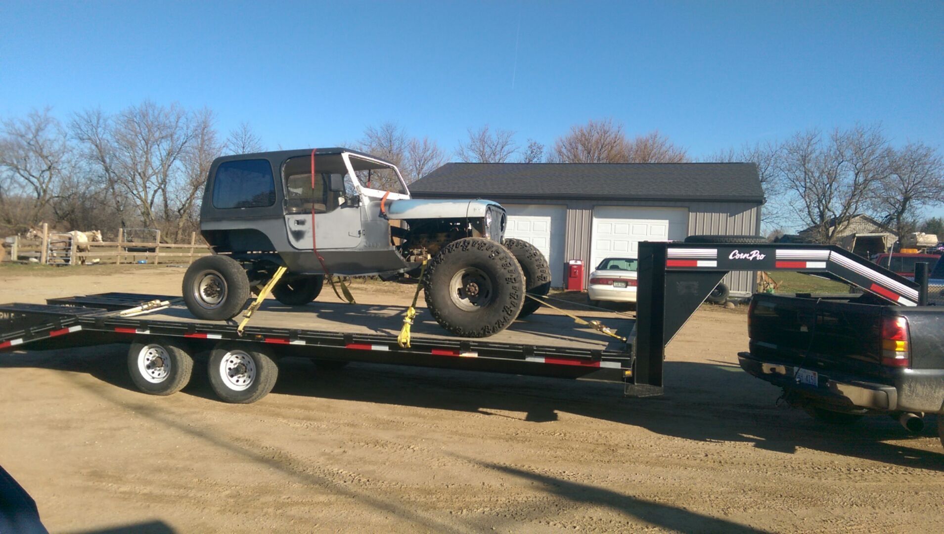

I started my first actual crawler. It's a stretched yj, 6.0, turbo 350 and a 205 t case. My question is what axles I should run. I have a set of 1 tons with 5.13's and also a set of rocks. I already have a set of 49" irons and a set of 46" claws. Not sure if these are to big or are perfect. I've built plenty of mud trucks so I'm always thinking bigger is better.any input would be great.

Thanks for the input guys. The frame has had plenty of work done to it so I hope it will hold up. From the belly pan back has all been replaced and plated with 1/4" plate. Boat sides are are 1/4" and stock parts of frame were plated in 1/4".Probably gonna go with the rocks. I have them in one of my other trucks and somewhat familiar with them.
Stinkin sweet boat sides. I think that's one of the biggest under rated upgrades ever.
They make such a huge difference in technical large rock crawling situations.
