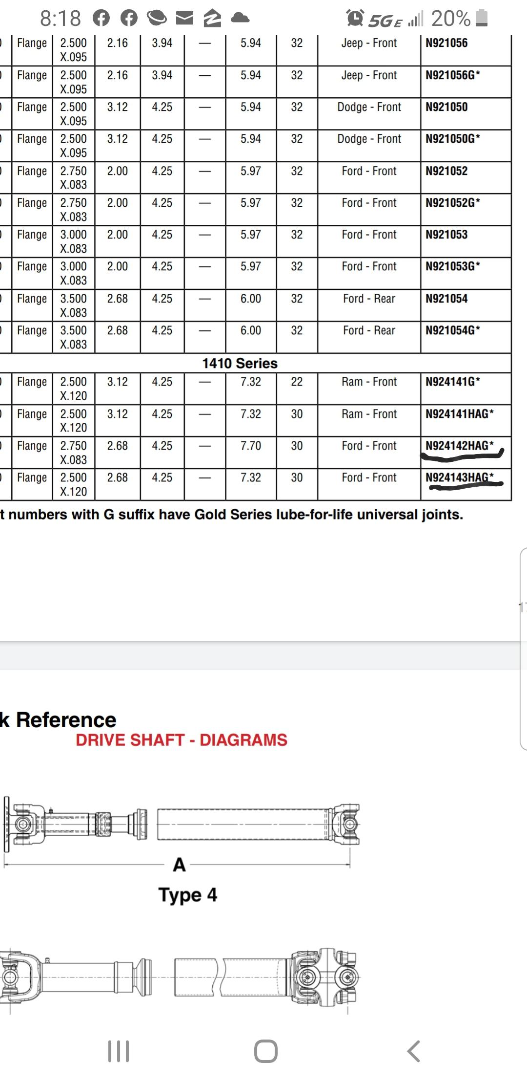

Yeah I used 2 in my xj build. A 1350 is in the middle and here is the part numbers for a 2in pilot with 4.25 BC
