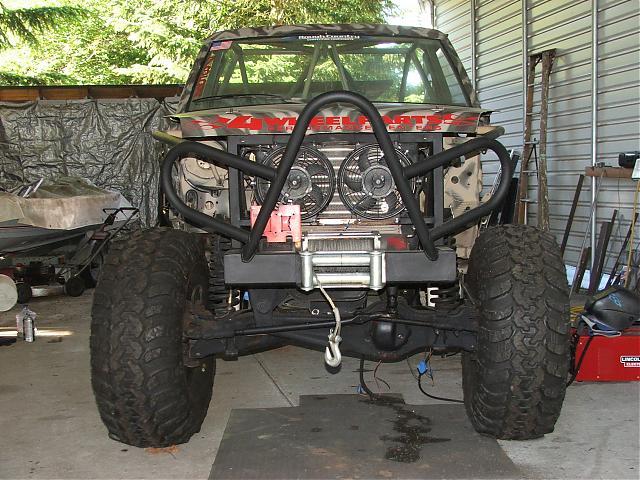

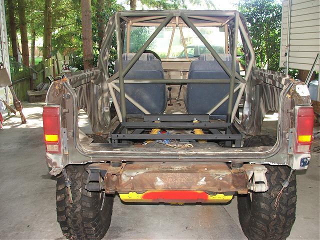

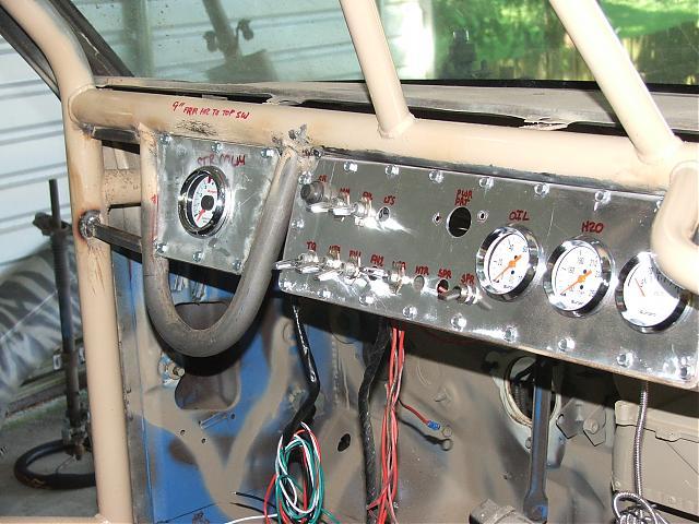

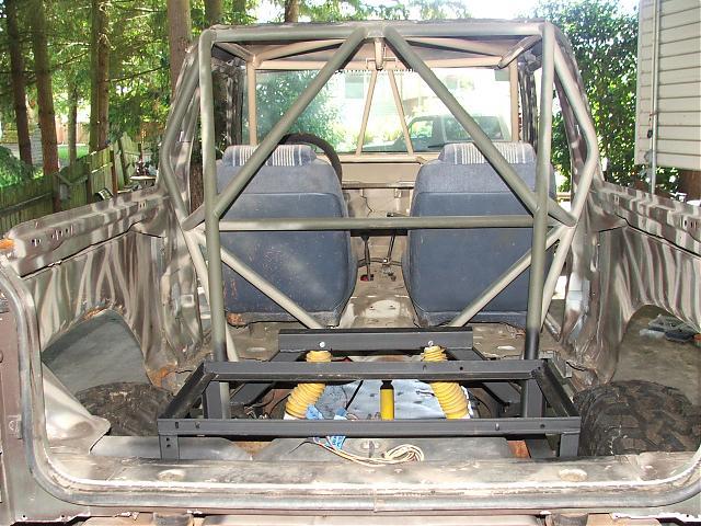

not bad if i say so myself this is what im transforming my 22yr ole faithful steed that Ive wheeled since it rolled off the assembly line in detroit . like I said I take my time and build it right the first time so I can play hard , ya know what I MEAN. :stirpot: :stirpot:

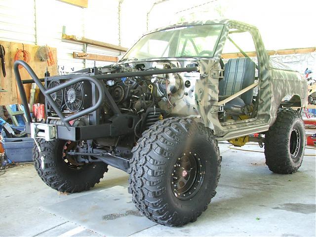

when we were talikn bout the d35 ttb explorer , the inner sector shaft stays the same the change come into play from the inner u-joint then you can run the d44 outer sector shaft /brakes/hub/spindles etc does it bolt into the outter ball joint without any mods ? its sounds like it would work to me ! run the d44 outer shafts with the rest of the fsb **** right ? what ya think!:awesomework:
