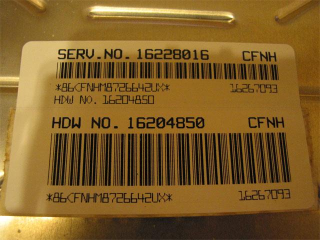

Trying to get the details figured out here...
Motor is a 2001 4.3 Vortec, I have original wiring harness and all but the o2 sensors and the computer. I'm told to look for a 96-97 computer but how do I make that work with the wiring harness I have, connectors are completely different. Or do I need the older harness too?

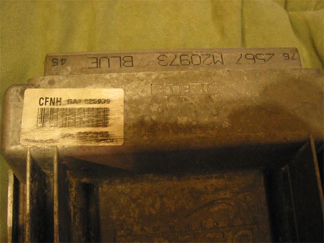

Heh, according to this page and the "CFNH" code on the sticker the ECM I have is for a '98.
They didn't use a delphi computer on a 4.3 until 2001. They did use them on buick 3.8 engines though. Code is wrong, or the puter is NOT from a 4.3.
Ya, that's what I was told. I honestly have no clue what it's from, which is why I'm hoping Crash can use his super powers to decode that cipher on the sticker.

So Crash.... are you able to look up what it is from? If I go with a 96-97 should I be looking for a wiring harness as well, and will that harness plug into all the stuff without having to change anything? Or is it better to redo the plugs on the harness I have? I've found some passlock 1&2 bypassing devices designed for use with remote start devices, if I used one of these I'd think I could use any ecm. Any of you guys know about these? From what I've seen they simply trick the ecm into relearn mode every time you start it.

Uh... :wtf: Same service number, identical to the one I have. Dude claims it came out of a '95 S-10. I'm totally lost at this point...:mad: :mad: :mad:
