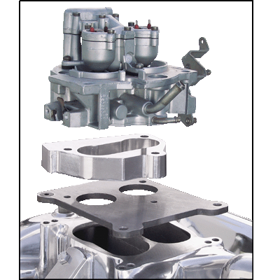

You need one of these. If it doesn't directly bolt to your carb holes (because Holly's are square pattern, and Rochester Quadrajunks are slightly wider in the back), it shouldn't be that tough to redrill it.
here's the link http://69.20.110.81/index.asp?PageAction=VIEWPROD&ProdID=126093
edit. Holly is generally considered a Square Bore, Rochester Q is generally considered a Spread Bore. I also don't think often about GM, and my verbage is poor. My bad.
And according to the linky, this should bolt directly up to your manifold.
