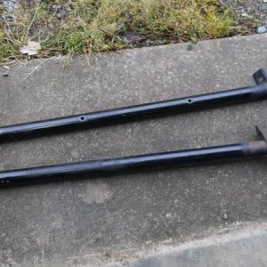

Hummm looks some thing like this.... From what i hear its easy to install ....I'll let ya know in two weekends...:FIREdevil:
