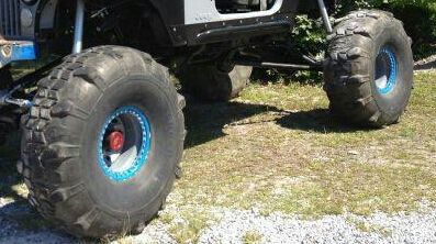

I ran mine like this back in the day and loved them
Thanks for picture I still ain't decided to go cut 44 tsl on all 4 corners or cut 44 tsl up front cut 44 bloggers in back

Tennessee cut
Badass cut imo. That's how I'd do mine if they didn't wear so much quicker. Though once this first set wears out I'll probably do that.
