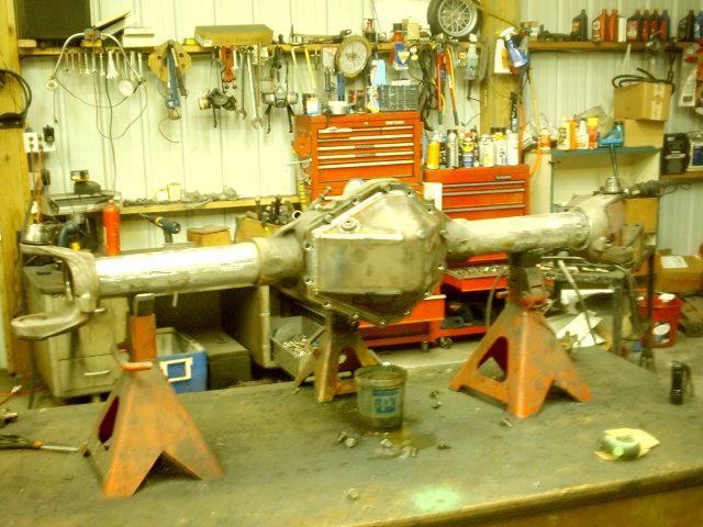

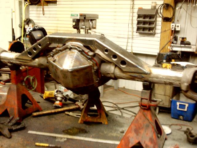

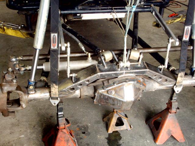

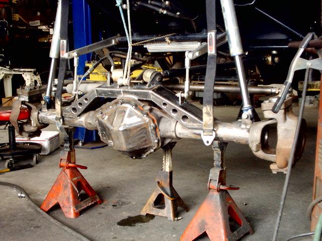

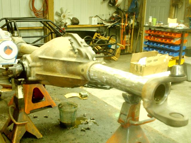

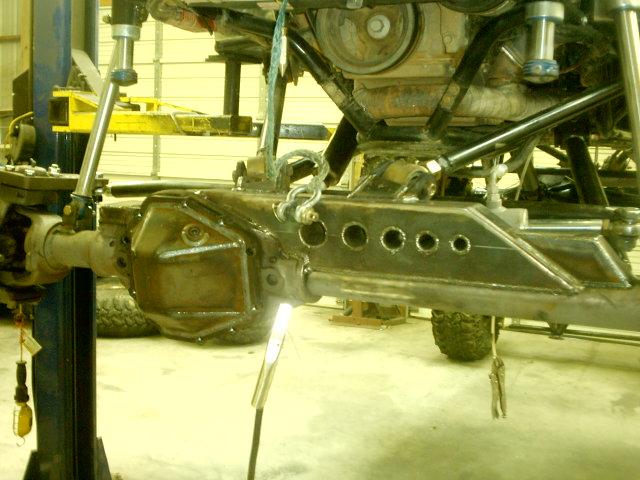

60 Front Rear steering 14 bolt Upgrade

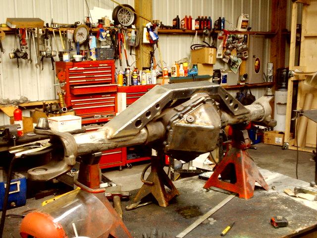

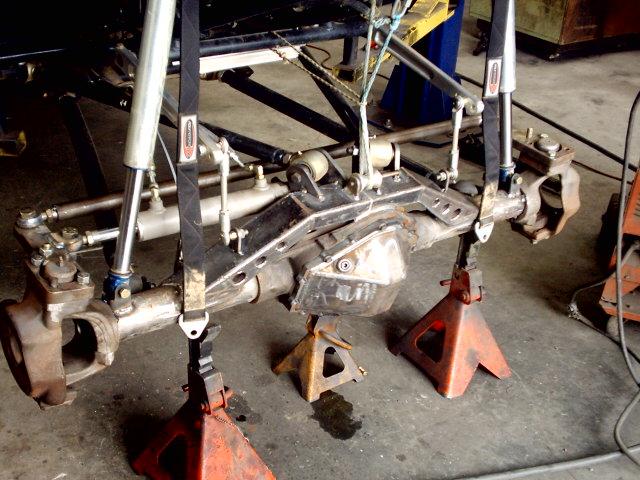

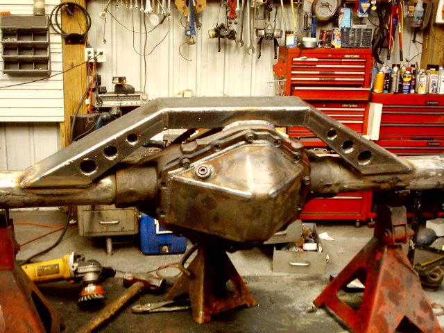

Man you do cool work. . Are these the same width or are they narrowed? What axles you going to run?

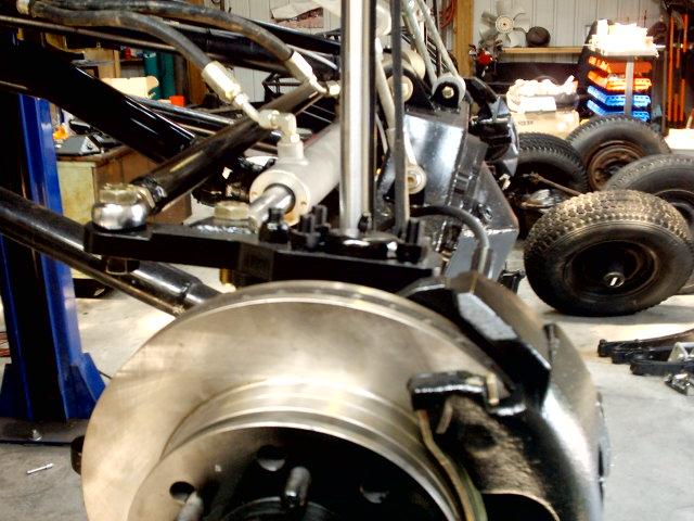

Curious to see how everything clears with the tierod behind the axle.
Thanks>>>>I am keeping full width on these... clearance on the front with the tie rod is really similar to the clearance i had with the 9.5 toyota stuff.. It has almost the same amount of uptravel..
Nice Work . Not to take over your thread hear , i see you running the jonny joints with threads made on them . How do you like them ?have you had any problems with breaking the casting ? I am running just the standard ones that weld on right know , But i am looking for a good joint to thread into my new bars . And lets just say that heims joints are expensive and noisy .
I run the same joints with no problems.

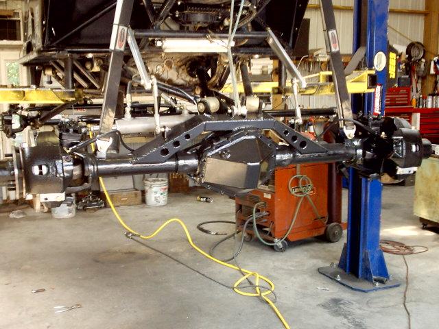

Nice work. What seals are you running on the steering 14 bolt?
Re: 60 Front Rear steering 14 bolt Upgrade...rear mock up
Thanks,, I am running seals it. in the tube.. we will see how they work..

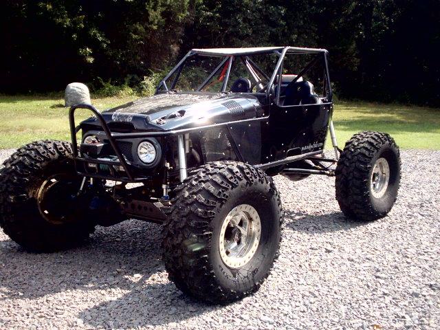

He just called me and said he won!!! He said the rear steer helped a ton. Sounds like he needs a big radiator and coilovers!!!
looks kickass
what'd you do to the rear hubs to get 6 lug? just had them turned down?
i like your work buggy looks awesome
