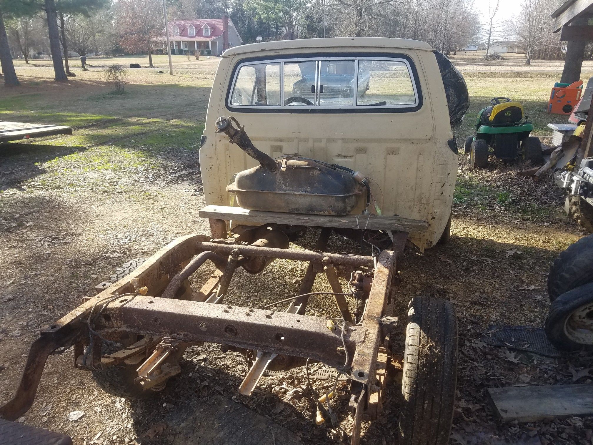

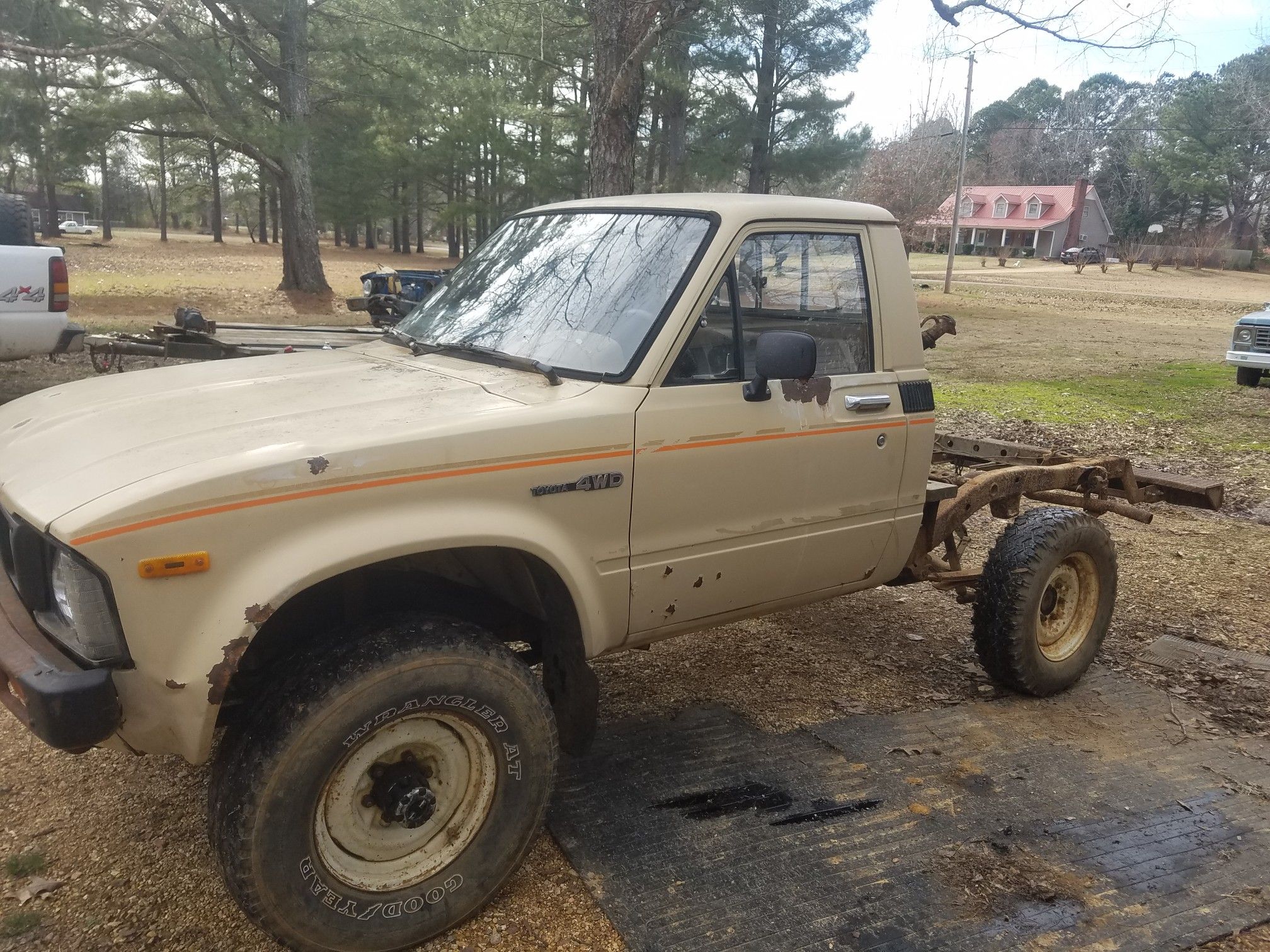

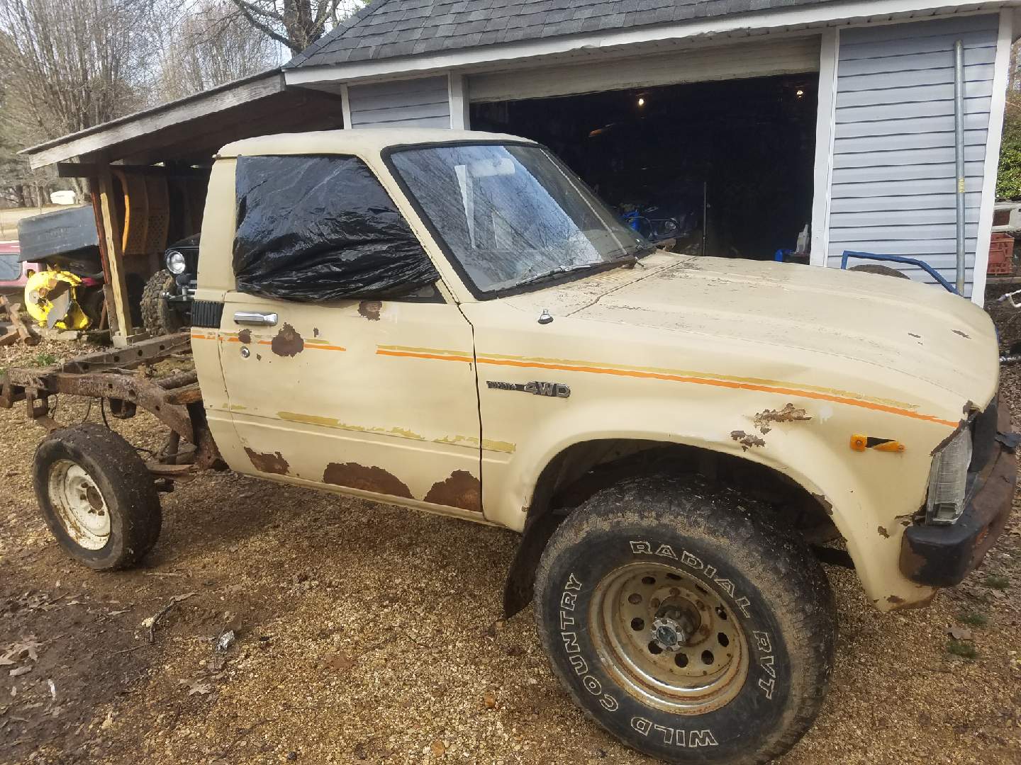

Took the junk bed off, moved fuel tank and redid fuel line/pump. Got the exhaust spliced and quieted down, could hear the blower motor run but nothing coming out anywhere, found a huge mouse bed just behind the vents. Removed the nest and vacuumed really well and now heater is working. With a set of tires it could drive more than just around the block. Slow go but it's coming around
