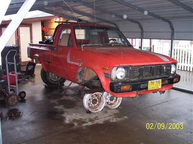

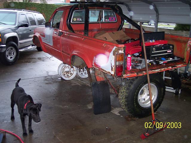

well ive had 5 toyota 4x4s.....jus never really built one. so i got this 80' sr5 from my cousin that bought it new. gave em 540 bucks and a dana 44 front end. it came with a 6" lift and 35s. 20r with weber n header. 4spd....sold the lift for 250 bucks. and i bought some trail gear 5" front springs for 100 (2 weeks old) and i got 1/2 ton 63" chevy springs for rear. ordered tg high steer kit,14" shock hoops,front spring hanger,ifs mountkit, 1.5" whl spacers to match ifs rear end im puttin in. 5.29 yukon gears. rear tg creeper joint shackle hangers. and 4 14" bilstein 5125 shocks. gonna do a complete rebuild on motor. bore,grind crank,deck block,surface head,rebuild head with custom cam.port head.and good pistons. centerforce stage 2 clutch for the 5 spd i got for it. and dual cases in a couple months. gonna do all gussets and what not for front end. and build rear shock hoop. got some leather power seats out of a 2000 suburban im gonna put in. heres a pic of when i picked it up. and what it looked like 8 hours later :D ....ill post some progress pics....when theres some progress:beer:....and no those pics wernt taken in 03' lol ....and im also gonna be buildin a sweet lil flatbed for it. and its gettin 38.5-11-15 cut boggers...jus incase were curious

ya that was jus temporary so i could get the lift out. all my tools n stands were at my shop @ grandmas....its not quite OSHA CERTIFIED :D .....and any tips or suggestions on anything more than welocom. always up for learnin.
