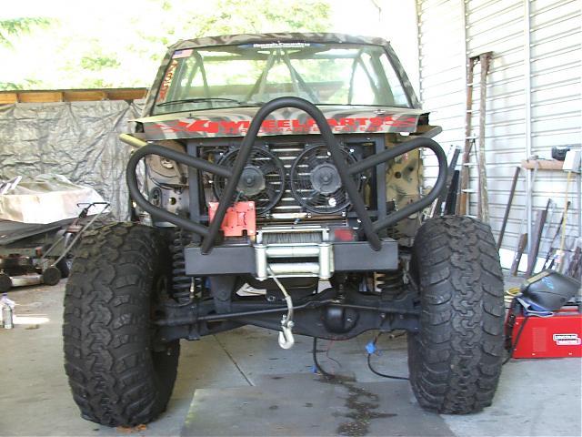

Well for starters the 9/44 combo is a great 1/2ton combo are you running the ttb or straight 44? I wheel a BroncoII with a 2.9l a4ld and run full width axel sets front and rear the 44 ttb out of an 86 fsb full spool in rear w 5:13 yukons and detroit true track up front 37" irocks for now and have had no issues also use warn superduty hubs these are the one main weakness that I have found so far. definatly truss the rear and run james duff trail front runners for better articulation and run the single shock set up , and place a u joint plate to protect the obvious. you can get a lot of good ideas from BRONCO DRIVER magizine , broncos are all they cover. TOMS BRONCO GRAVEYARD has lot of great tech support and build parts too. check iiiiittttt!!!!!:awesomework: :awesomework:

i am running the d44 straight axle out of the 79 bronco with radius arms fully rebuilt with upgraded gubs and u joints
