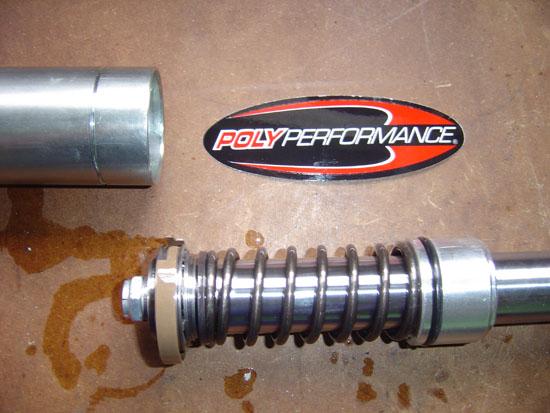

Only one I have, from a post about the negative springs in them

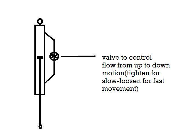

I have seen hydraulic cylinders used as shocks. the owner used a valve between the two ports to control motion the same in each direction (kinda like a bypass). I have also seen hydro cylinders attatched to a lever to raise and lower each corner independently. when the lever for each wheel is in the middle position it allows the cylinder to float on compressed nitrogen, and having a valve inline to adjust how fast the fluid can flow (dampning).

hey brad the hydraulic cylinder you mentioned is comonly used on tilt deck trailers..... they use a hose from the rod port to the base port with a common needle valve in between so you can choke down the orifice and control the rate the fluid can transfer from port to port :) Ok looks like i am really gonna try this from scratch was just looking for some design info for a place to start......:beer:
this as simple as I can explain it. I wasnt talking about internal valving.
if used as a spring you only need a single acting ram then and just put a valve inline with the hose to quicken or slow flow.

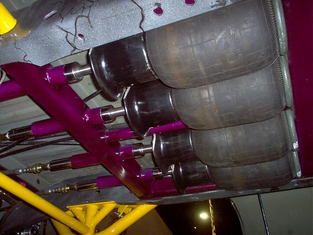

hehehe that is so farm tractor.... I really need a internal flow control machined into the piston that is pressure compinsated to vary with the load. That way it will auto adjust to the load rate applied at the time..... I was thinking the high end shocks like king and fox ran a similier system in them. Just wanted to see one a part to give me some design idea's. I am not real big in springs in cylinders if they brake they scratch the cylinder bore beyond re-honing

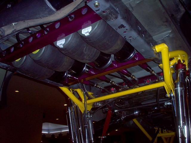

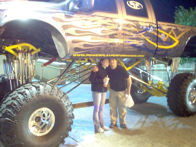

when i was referring to springs I was thinking of a setup like this. I seen this truck drive into the luxor and wait for valet parking. it has rams connected to bags so when aired up it lifts. the other setup i do not have pics of, it uses a ram with a hose connected to a tank with pressurized nitrogen for spring pressure.
your right on with the trailer comparison, i couldnt explain it better. looks like your going to build yours a little cooler though.:awesomework:
