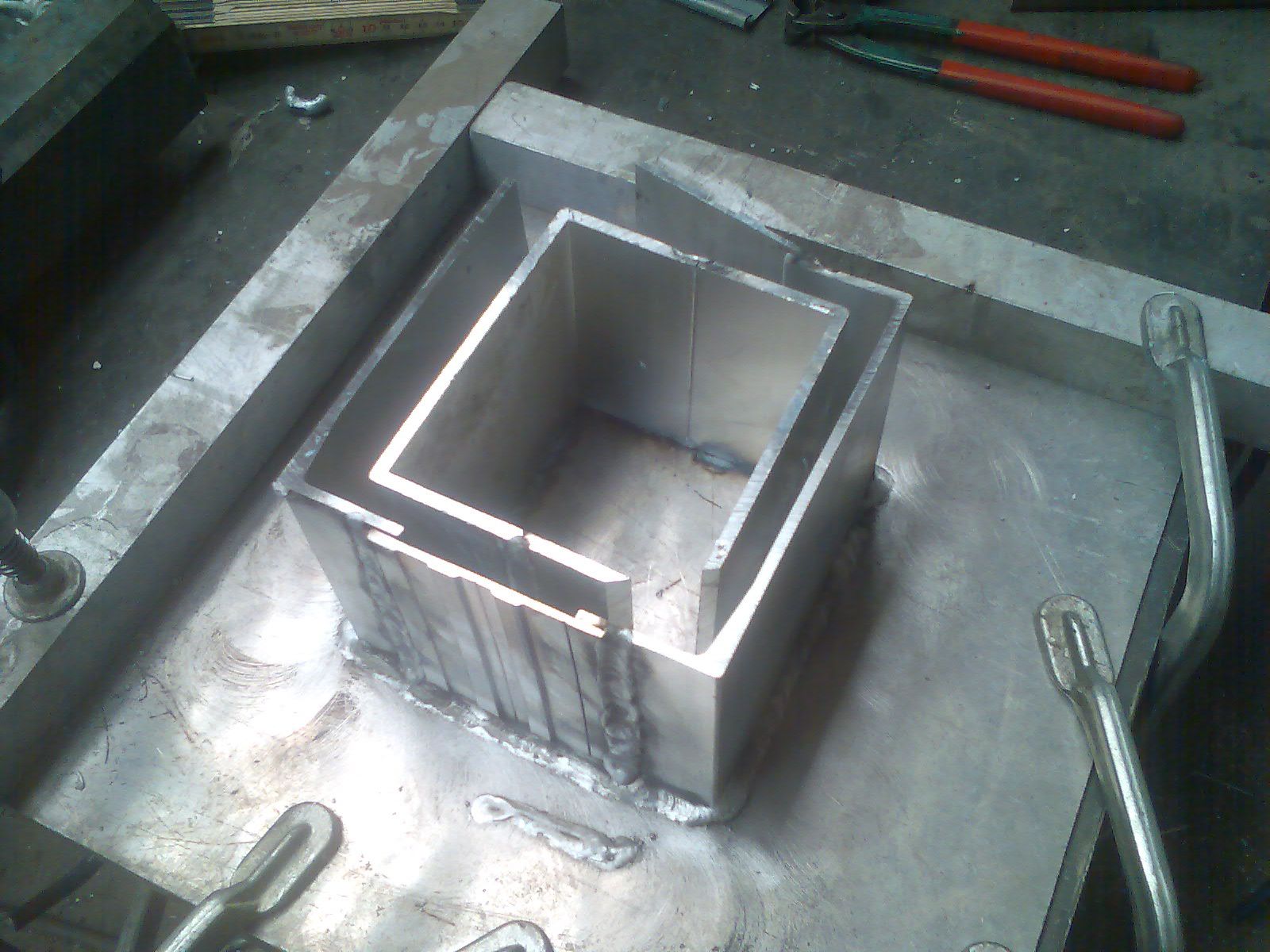

Planning to ditch this one because it cracked, it has no internal baffles and 15 gallons is just not enough for a full day of riding for my thirsty beast.
here is a side view and a top view of the new fuel cell.
the plan is to make the sides from 3/16" thick aluminum and the rest from 1/8" thick aluminum. the idea of making the sides from 3/16" thick aluminum is that the 1/2" thick mounting blocks will stress the sides quite a bit at the welds and don't want it cracking there. the internal baffles might be made from 1/16" thick, but most likely will be 1/8" thick too. two of the internal baffles will be complete ribs that will be running front to back. I saw a guy did something like this on here and said it worked really well for his set up. I planned to add two more baffles just to keep more of the fuel at the center in extreme downhill/uphill applications.
let me know your thoughts - I have thick skin and would rather know what's not going to work before I waste a bunch of money buying, shearing and welding a bunch of aluminum that is not going to work any better than what I currently have. Too much baffling? going to crack anyways?
