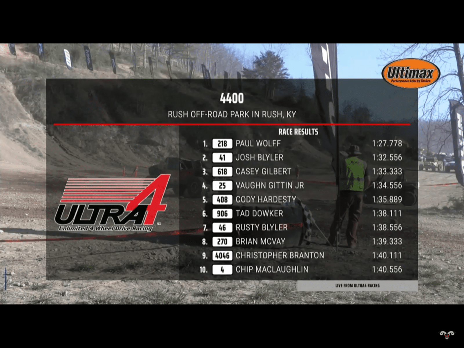

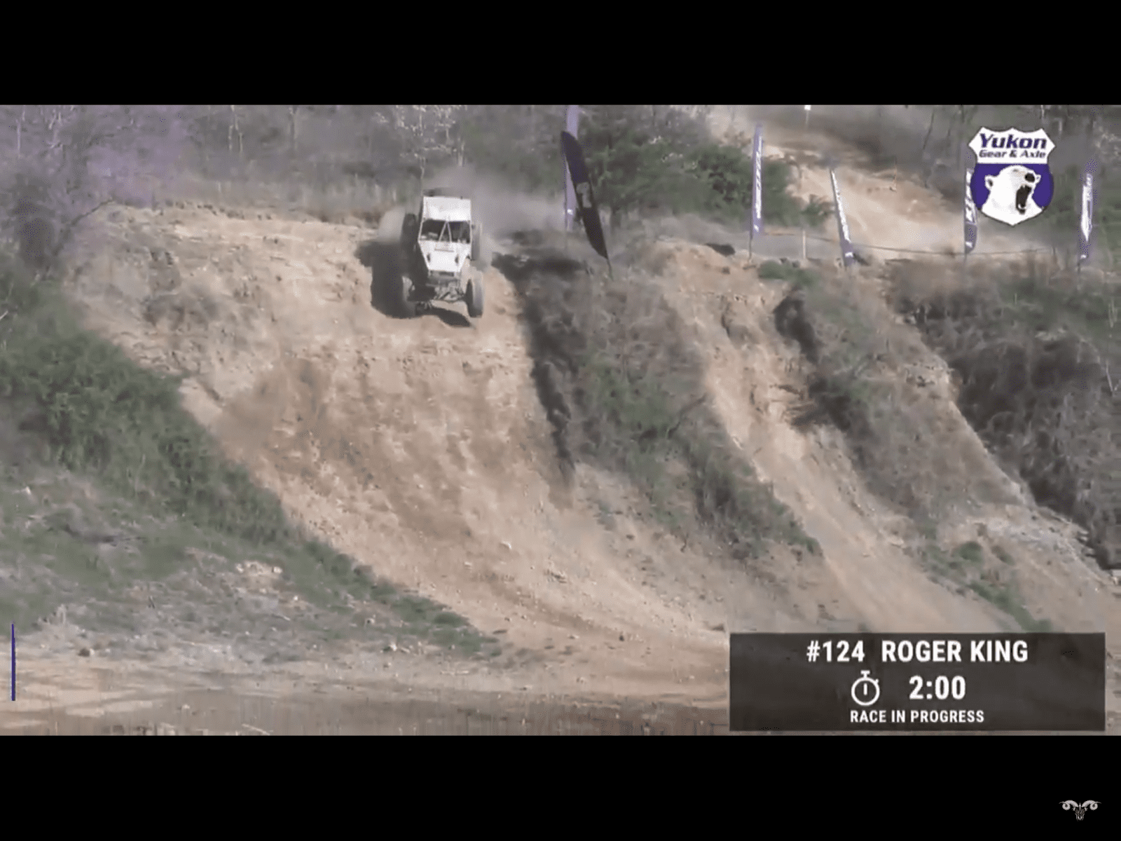

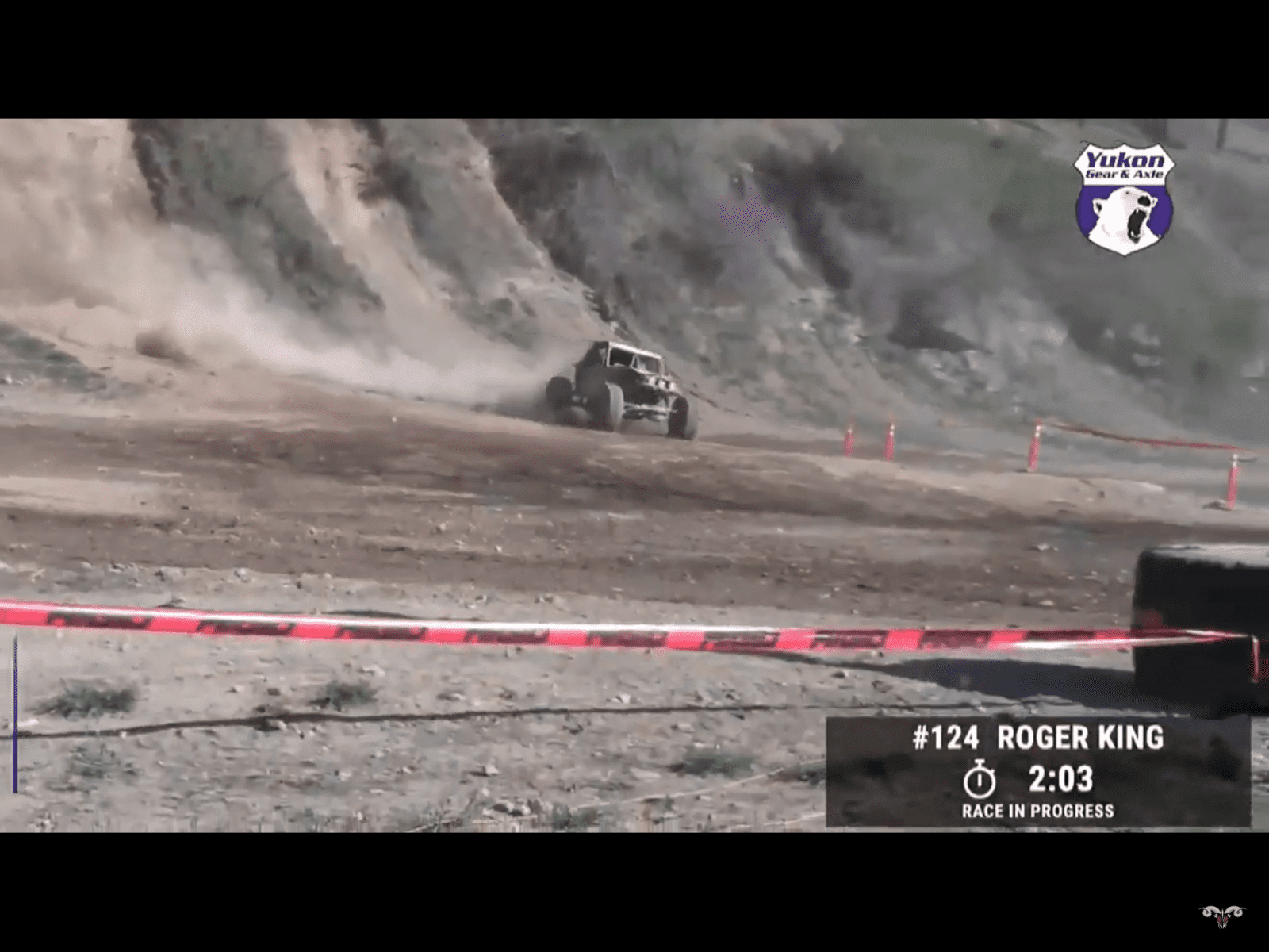

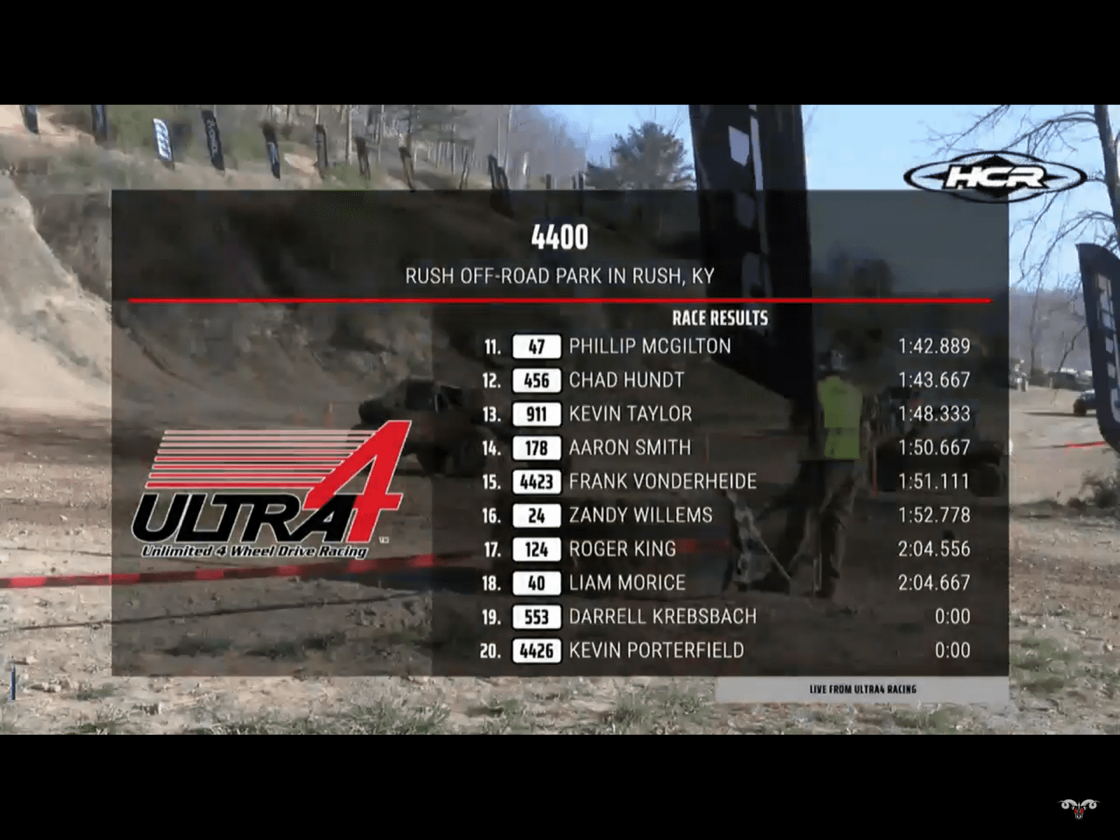

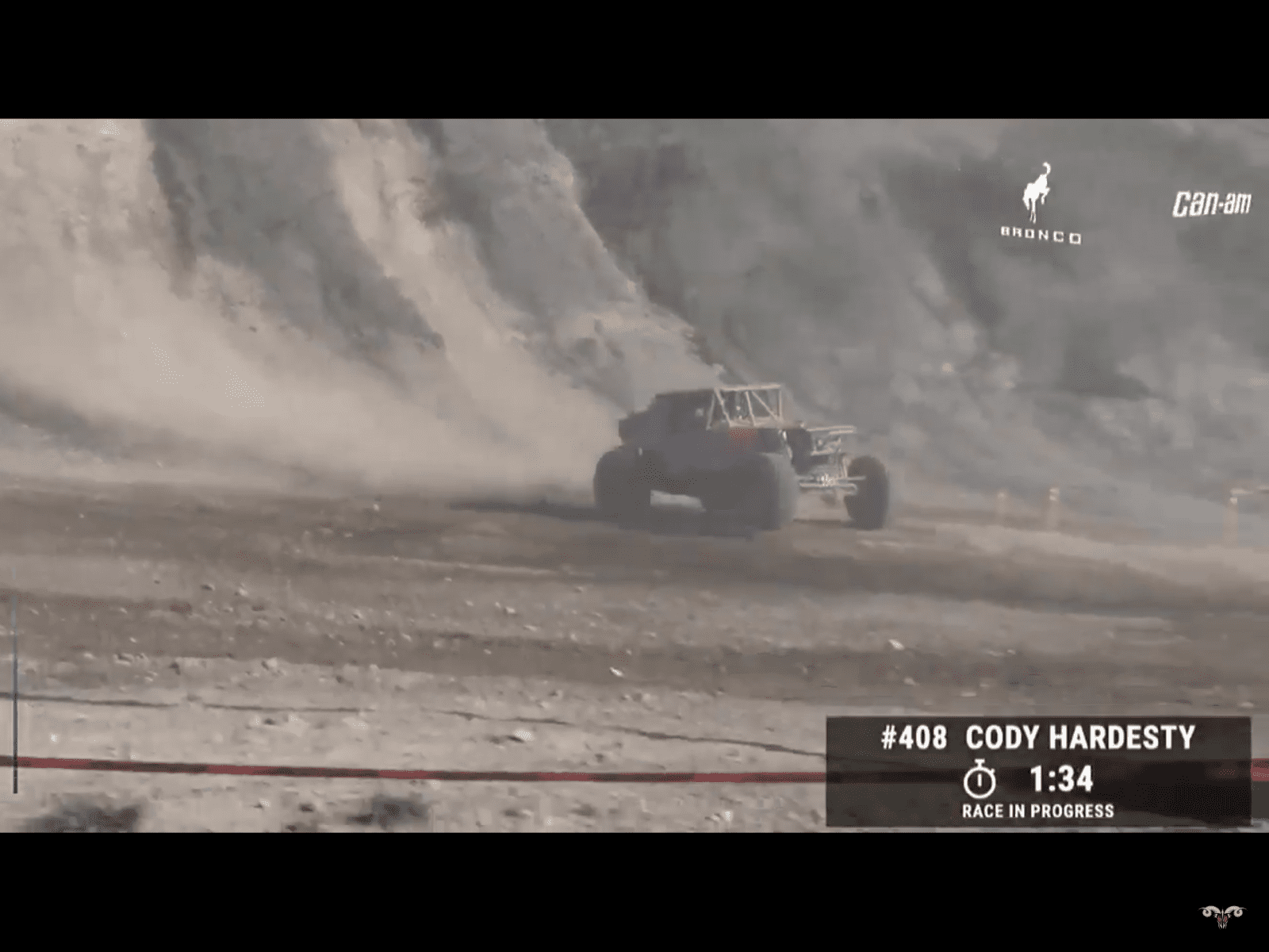

Some screenshots from @extremetownie and @wizzo (assuming he's with Cody Hardesty) qualifying runs

Race was going great. We were running fast and on the edge. Basically where you have to be to run up front. Then we lost brakes on our 4th lap. We had been running in 3rd at that point. We finished 8th after stopping in the pits and then limping the buggy around the course.
Something got a hold of one of the flex lines by the knuckle.
Cody has a single pedal balance bar set up. So when we lost fronts, the bar twists and you have no brakes. I suggested to him from day one of my involvement that the balance bar needed to go. He knows why I've been asking for this change for a while now.
