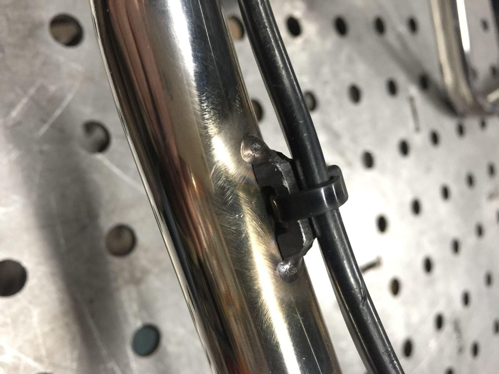

Anyone got pics of how they ran wires on their cage? I know multiple places make zip tie tabs. I would have liked to run it though the cage but forgot to drill holes. Just looking for what others have done to spark an idea. Thanks.
They have all that stuff pretty cheap.
