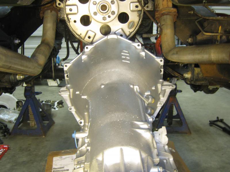

Quick Question
Would these trannys hold up to being a daily driver with the manual valve body? I am only talking maybe 10-20 miles a day or a trip over the pass on the weekends. Anybody see a reason the trans wouldnt be streetable?
