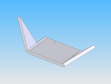

Here's a bad/unfinished photo of the hack job that I did. It is gussetted and boxed. A piece of angle iron would have done the same job.

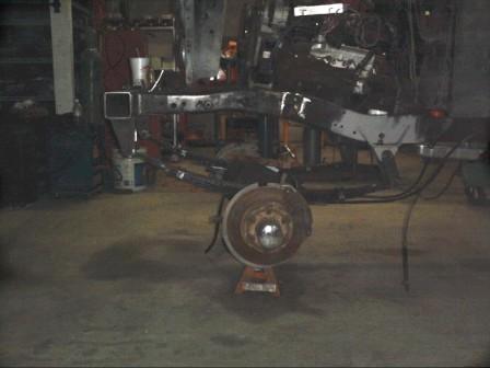

As for thru the frame, I originally started that way, see hole above shackle mount, but ended up with a waggy frontend and had to change things. Come to find out this is very similar to Blue Torch Fab's spring outboard kit. I was also trying to keep mounting points somewhat level, i.e. the front dropped spring mounts.

zip said:
So, I'm curious, can I just take my shackles, adjust for length, and just swap them around (front to back) common to the front springs? I probably would have to compensate for the pinion angle some, either by shim, or moving the bracket? What else?
Looking at Fubar73cj5 pics made me think of this, reading the other posts sure seem to make this a complicated process, is it really?
It's not that complicated. It sounds like your rig was already lifted so your brake lines, drive lines, shocks, steering links, etc. should all work out :D . I had to rotate my knuckles but only because I didn't start with the right front end (Scout). Tack on your spring and shackle mounts, set the rig on the axles with your perches tacked in place and make sure everything works as far as caster and pinion angles then go from there. I mocked everything together before welding it to make sure I only had to do it once. Everything in my front end as far as clearances go is TIGHT. Not sure if that helps you or not :redneck:
Good luck
