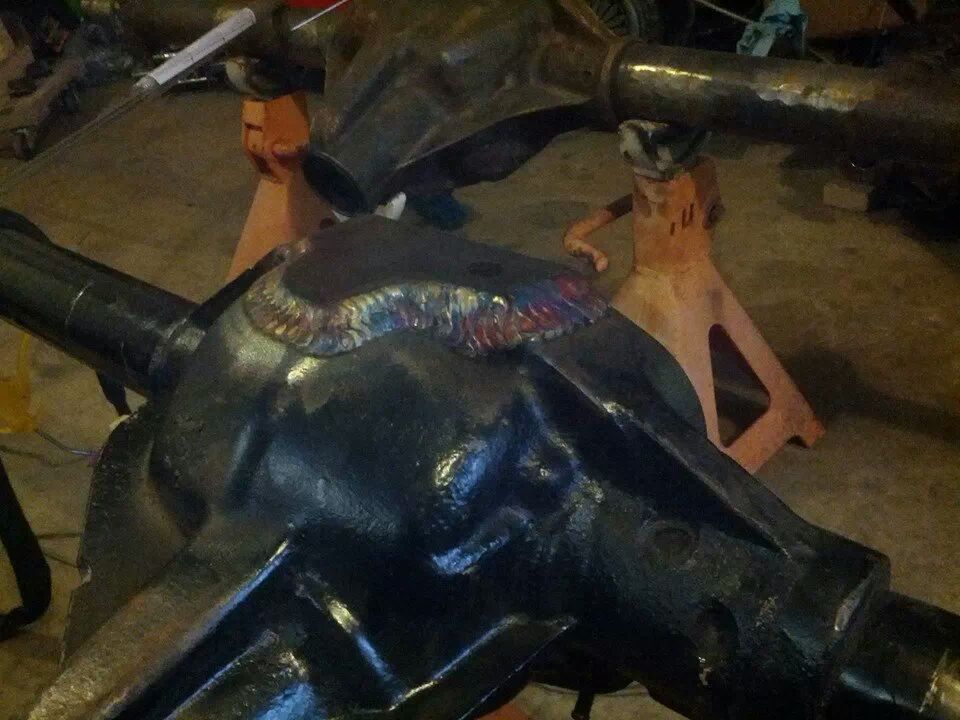

Here in the shop we are getting a jump on a future Tacoma build up. We have prepped a front and a rear Dana 60 to accept the Ballistic Fabrication shave kit and they are ready to be tig welded.

Dynamite Design said:
It is a high pinion.
How well did the Ballistics shave fit it,,, i know they are made for Low Pinions-- did you have any extra work in it ?
Wait,, i mean for the Low Pinion... i have a Dana 70 Im wanting to shave aswell.. Thanks

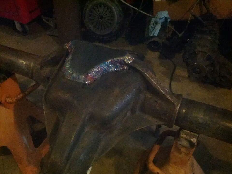

Does that piece of plate not suppose to kinda sit flush with the bottom? looks like you added back most of what you cut off, but it might just be the pic?
The pointed end sits flush on this one. I noticed I put a lot more work into this rear shave, compared to the front one.

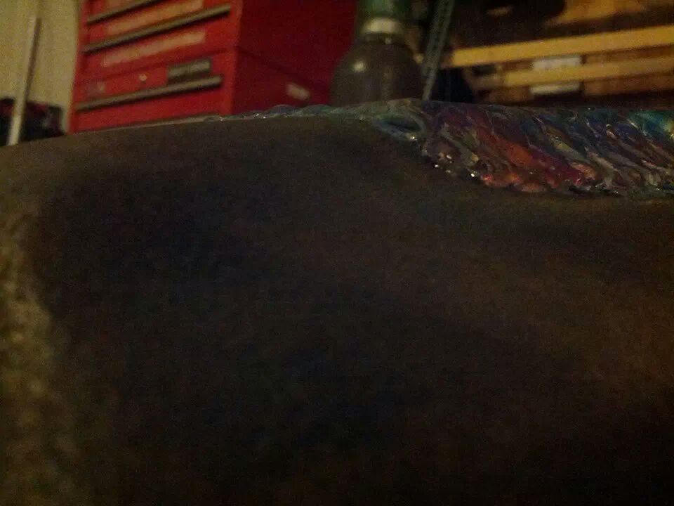

Someone on another web site asked me the same question. I should probably take more pictures of stuff to help the 3D effect.
