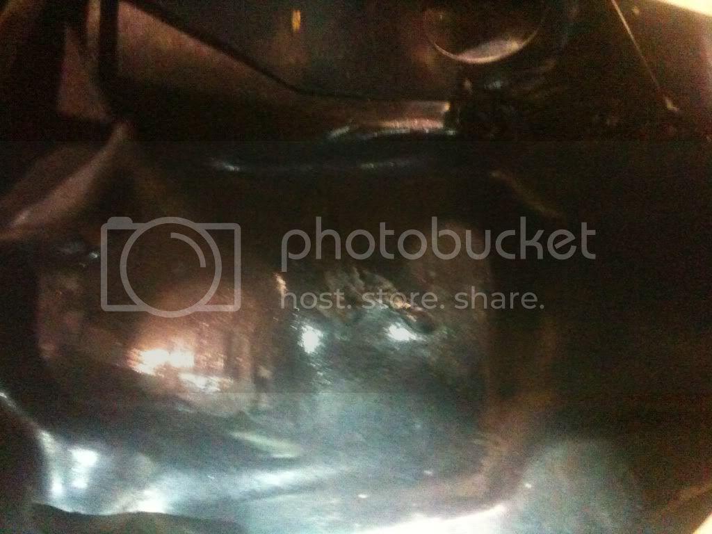

currie way better the dynatracs are thin and brittle....... a drill bit will fall through a dynatrac

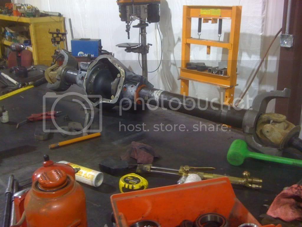

here is a pic of a repared dynatrac that cracked when the pinion broke

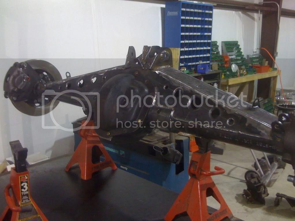

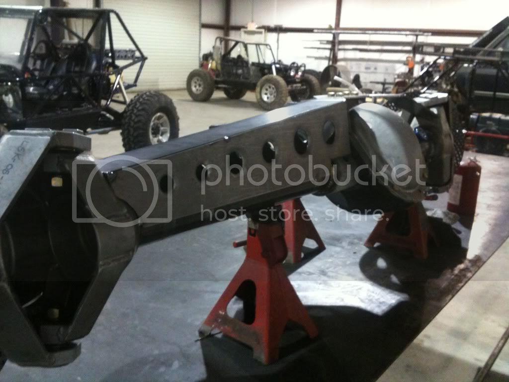

some i have built
