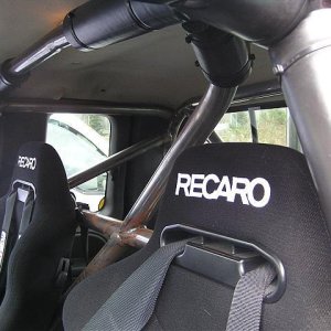

How all the tubes join up over the driver/passenger seats

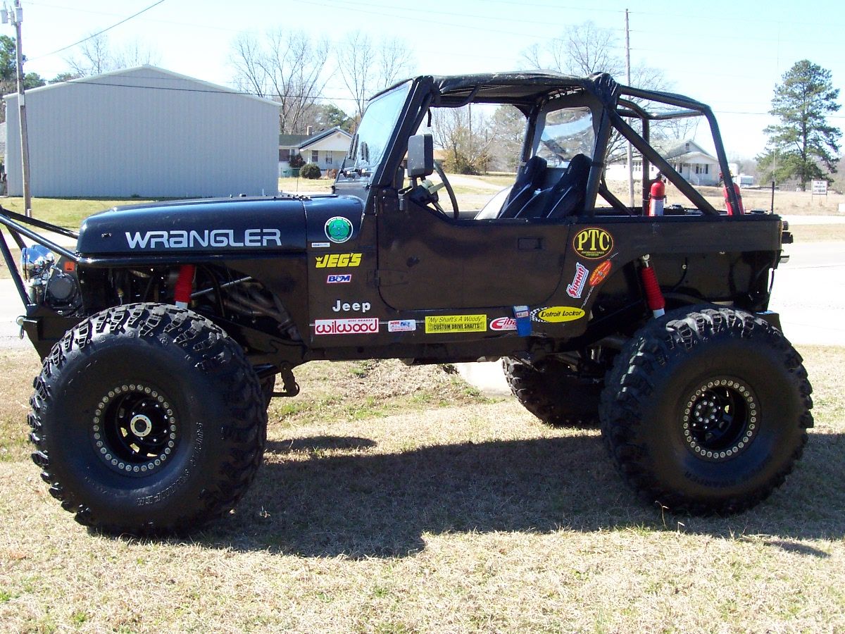

How it looks as of today
Now I just need to get the tub ready for paint which will be the same color as the frame, it's more of a satin black with a little gloss in it. Almost matches the label for jack daniels which i'm happy about :****:. Cage is going to powder here soon along with some small items, it will be a color changing "Whiskey" color that looks orange in the sunlight and brownish in the dark.
