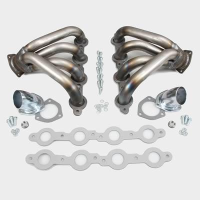

I found these
http://www.summitracing.com/parts/SUM-G9065/?rtype=10
They fit nicely.... the speedway ones are cheaper tho :dunno:
What do your motor mounts look like? I had to redo mine due to the headers being center dump... just an observation :dblthumb:

Those are the same as the speedways, both are made by patriot.
http://www.jegs.com/p/Hooker-Headers/Hooker-Headers-Block-Hugger-Headers-for-LS1/759625/10002/-1
Hookers fit tighter than the speedways do. I have used hedmans (garbage) thorleys (nice, but take up ALOT of space) several sets off speedways and like the hookers the best. The front and rear runners are close to the block, all the others the center runners are close, making the whole package wider instead of just the middle. Speedways are center dump, others are more towards the rear.
