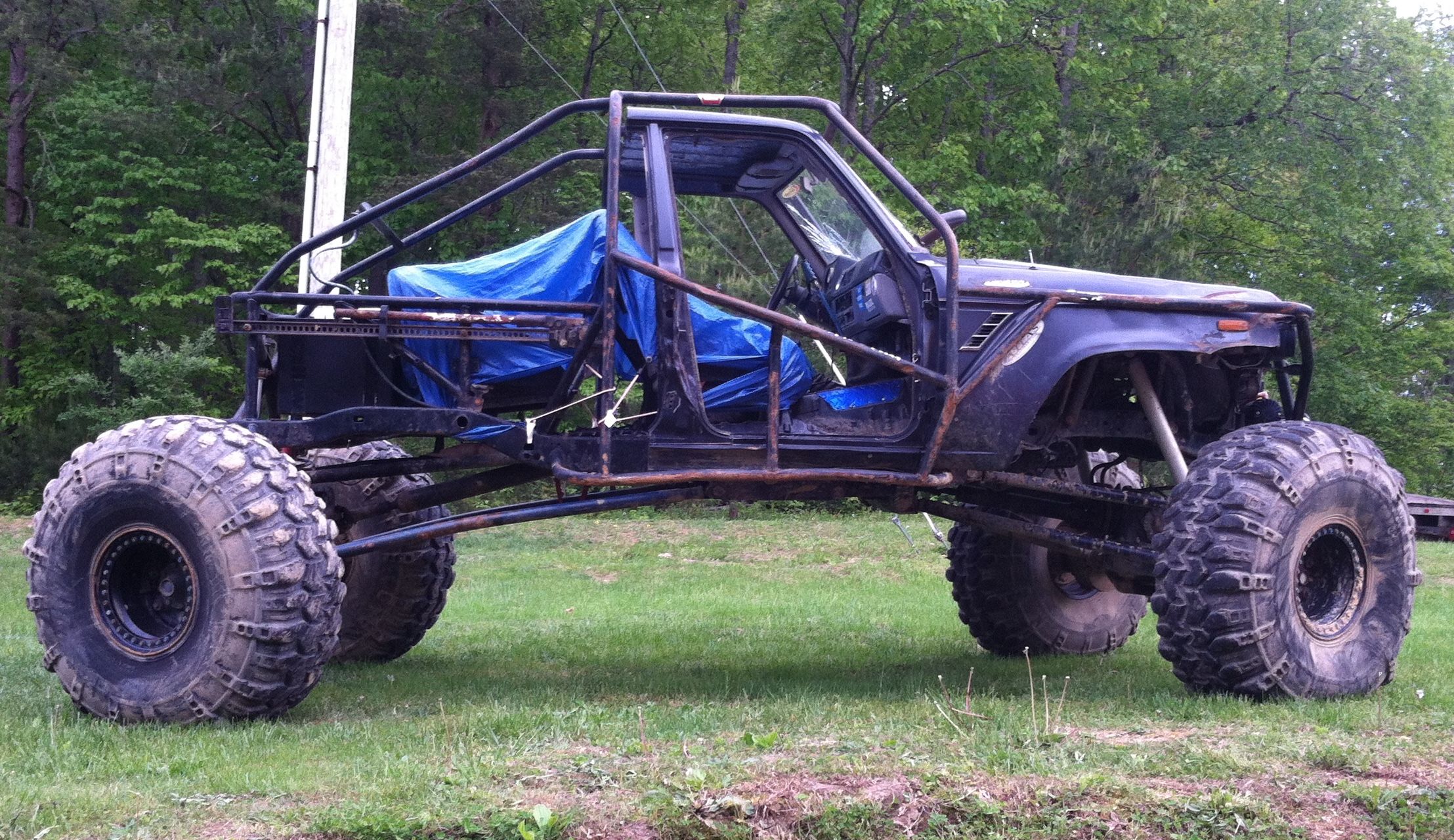

Ok so I was putting a truss on one of my customer axles when I noticed his brakes an thought hell that's cheating but it works . So post up what you have come up with that worked (might save some people a little money
Sent from my SM-N910V using Tapatalk
Its a 1/4" thick dust shield/mount, that's off what looks like a half ton front. Chopped and welded to the 14 bolt to mount the caliper. And the pinion guard is welded to the pinion cover/plate.
