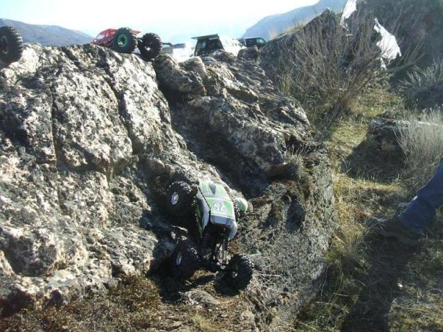

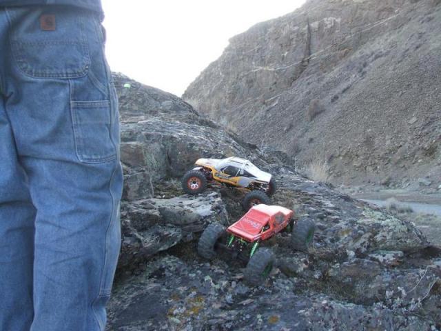

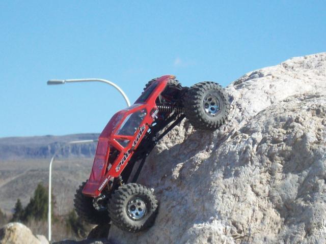

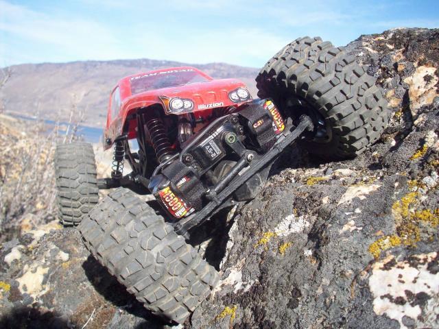

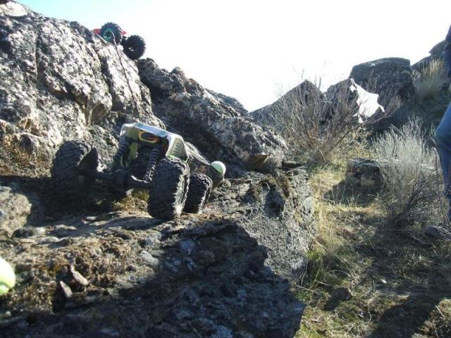

Here are some pics of yesterdays run at ROCKY REACH DAM LOOKOUT...i have weighted my wheels, star cut the foam, truggied the stock body, and have some saddle pack batteries and plates and other goodies supposed to be here today. getting a 55turn motor from a friend hopefully today also.

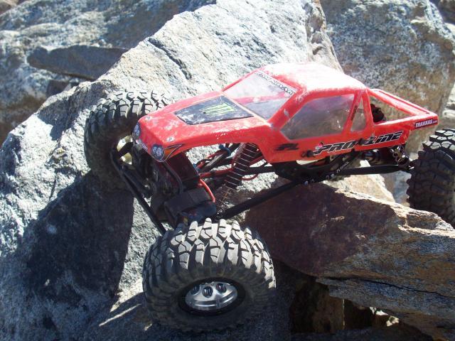

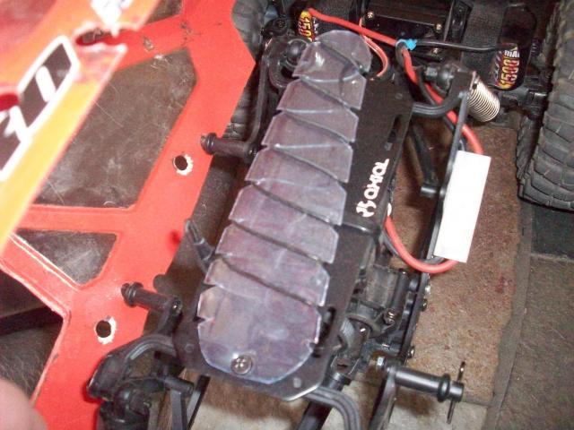

so, I have this done so far:
In order,
14tooth pinion(spare parts with it)
installed front locker(spare parts with it)
weighted the wheels 6 front 3 rear($5)
drilled a 3/16 hole in each wheel for air in and out(free)
star cut the foams(free)
recessed front screws for better turn radius(free)
silver soft springs in front(Free)
saddle pack plates($10)
saddle pack battery($24)
55 turn motor(trade)
Flat Iron tires(trade)
crawler body(trade)
stuff to make own saddle batteries(trade-new)
inboard lower links, cut 4 notches out of crossmember plate
ground down with the bench grinder the stock links and flipped them so that have more ground clearance in the middle.(free)
antanna in under body with some stock body plastic with notches and rapped around it(free)

Looks very cool. how do you like the flat irons vs. the stock tires? I need to inboard my links too. Looks like it works really well. Does your reverse require a pause at center before it goes into reverse? I looks like it is doing some really steep climbs. :awesomework:
I like em so far, I've been going places the lizards couldn't touch before, same exact lines, except now I can actually go up them without helping it or going around some of the obstacles. the best things so far to date would be the battery on the front axle(low center of gravity is key). then the 55 turn motor. then the new tires(the lizards did much better with weight and star cut foams and the hole drilled in the wheels, plus I siped all of them with a razor). but also the front springs also need to be way softer than stock, im using just the soft silver springs on front and the stock firm on the back...tell you the truth, im going mostly the same places the guys with the "good ****" are making up....alot of it has to do with the driver.
My problems so far with all the current mods are that im in need of a good ESC with braking...im gonna spring for a novak rooster here soon, im just trying to get all the free stuff out of the way first. i didn't notice much difference, even though it was easy, inboarding the lower links. pretty much just makes it so you dont hang up on them from what i can tell. I found a traxxis tq3 3 ch remote with receiver for only $15(NEW) on ebay and that has the thumb toggle for the 3rd ch which will be used for my "future" dig, plus that stock axial remote is a super major pile of nasty brown smelly baby ****! I hate it, but I cant afford anything fancy yet and I know alot of people using the tq3 and seems to be working good for them for what you get.:awesomework:

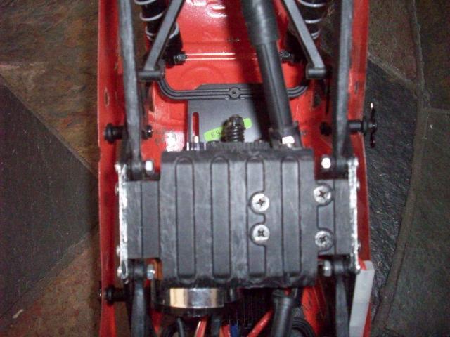

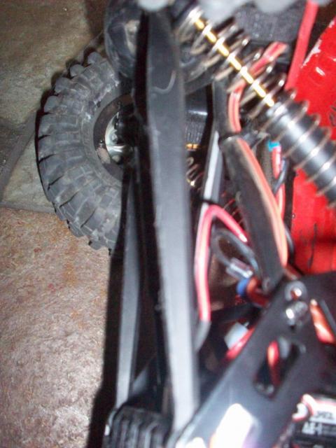

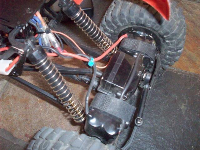

here is the inboarded links, the antanna mount, the lower links ground down and flipped so the fat part is on the axle side instead of being at the chassis end, and my battery setup with plates. Oh, and me crawlin over my boy!
flex?
is to much flex bad? im debating it, because i have tweaked my suspesion so well that i can flex my front axle almost 90 degrees without either of the rear tires leaving the ground, im using soft silver up front and stock grey firm in back...when i inboarding my links on the axle side i put from outside to in...
2small washers, spacer, link then shock on the outside of the stock mount then the nut...basicaly moved the shocks inside the links, which is opposite to how it comes stock, i did this so that there is no more binding up with the links at full flex either way. but in turn it makes it flex much easier cause there is more leaverage against the shock and the further to center you go the less the shock moves the further it flexes, same principle as real life...any input?
I would assume that flex is good because it allows for all 4 tires to remain getting traction at 4 different locations...i guess i will just have to test it for myself. I can see it being bad in some situations...but i dont know?
Almost 180*???? I think you mean 90*....no way it would even work with one axle UPSIDE DOWN.
And 60-70* is plenty......
