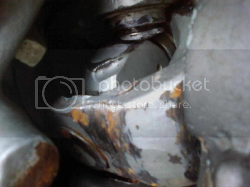

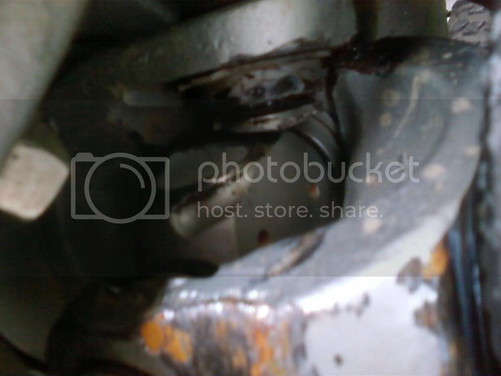

I know P broke a Dana 44 CTM, but I haven't seen many broke 60 CTMS. It is connected to Superior shafts and they seem to be fine.
Here is a picture that was sent to me.
I havent heard of many 60 CTM failures either.
Yes the 44 is stout, yes you can get away with alot ( more than the balljoints can handle ) yes it will still break molaugh
So heres the real questions, how old is the joint , how hard has it been ran ( what application of rig ) what kinda HP were and when did it happen ?
Nice to see that it was caught before the ears got destroyed 100%... a can see a little ear damage in the pic but it doesnt appear to be insanely critical.... (from the pic )
whos is it ?
This was in Bryan's buggy. It was greased every 2 rides. You all know his specs. Broke it at Wooly's for the RTM Shoot.
I believe the axle is fine and can still be used.

Yeah but I wouldn't expect the CTM to break before the axle :dunno:
I would throw all the expectations out the window when Bryan is driving. those guys can and will break anything
I have broke one. Peckerwood at Tellico. It did not hurt either ear. Nick had a spare, we broke it down and fixed it on the trail while the group ate lunch. If you run CTMs carry a bolt to back the caps out, much easier than a hammer, which is what we did.
