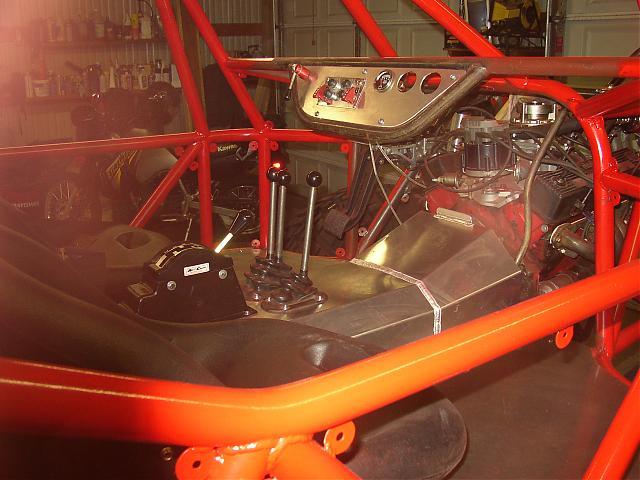

Putting the floor in my buggy right now, i am planning on bending a couple tubes to span the area over my tranny to help support the inner seat mounts and give me places to attatch the floor metal to. I am kinda drawing a blank on how to do this cleanly. i have a pretty signifigant hump cause my drivetrain sticks above the frame rails by 5-6 inches about halfway down the th350 but only 1-2 inches at the tcase. Any pics would be appreciated.

I made an aluminum tranny cover and floor. Hope this helps.
It just takes time and a little imagination.

Make it outa cardboard first with ALOT of thought into "removal with cold fingers".I have a drivers floor,a trans tunnel and pass floor....the pass floor pops rite out for speedy access to the front D-line,the trans tunnel comes out fairly easy then last is the driver floor which comes out with a wiggle.Minimum bolts,tight tolerances and easy access....just lots of thought and TEST FITTING.....cardboard is youre friend.
Oh..............and being able to tig helps as well
