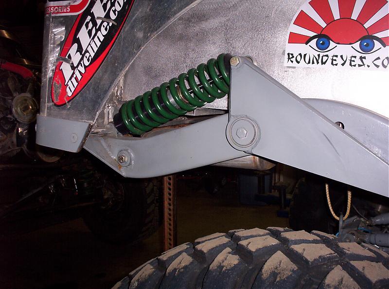

Not exactly sure what you're looking for but...
( http://www.pirate4x4.com/forum/attachment.php?attachmentid=340681&stc=1&d=1197268561 )
Me and Bill are the ones trying to build it. We've almost scrapped the idea, mainly because it's pretty complicated, and more importantly, we can't package it. There's to much stuff going on in too little of a space
So are ya'll going 86 the whole cantilever idea? I was looking forward to the build. :'(
I think so. I think we're going to try coils and nitro shocks, if we're not happy we'll change from there.
