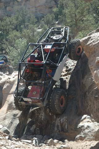

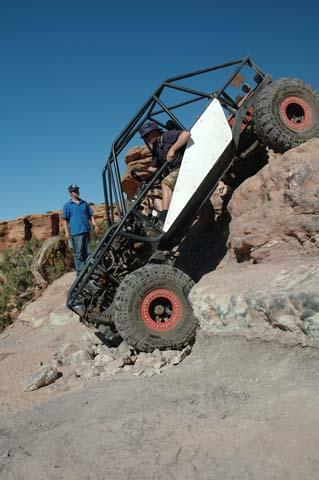

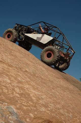

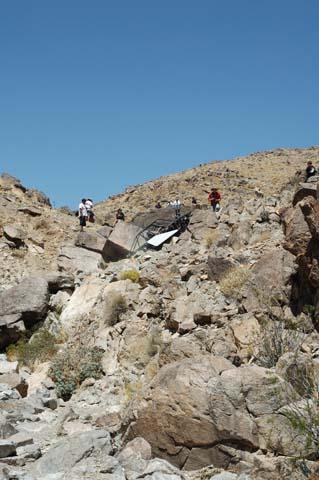

In my ftyoy I run the floatbowl venting hose and an msd ignition, haven't needed anything else and the truck will run at any angle. it never stalled on any of these.
