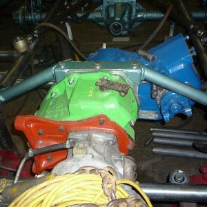

I looked all over for this and finally found it on a backup! This is my shop, circa 2005 doing a tailhousing swap on a brand new Atlas. Good times.
edit: This whole picture is just great. Blown apart new Atlas, time stamp on the picture, Nokia phone. Amazing.

and only 1/3 of the **** on the table is Atlas parts :stir: :stir: :stir: :rolf: :rolf: :rolf: laughing1 laughing1 laughing1
