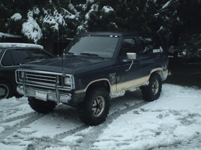

Junkyard 1.5" lift = 4 door explorer springs front and rear.
With 32s even.
Throw some large washers under the front coils. You can fit about an inch in there and still have full engagement on the retaining nut. With that and a little sawzall action you can fit 33x12.50 :awesomework: :redneck:
