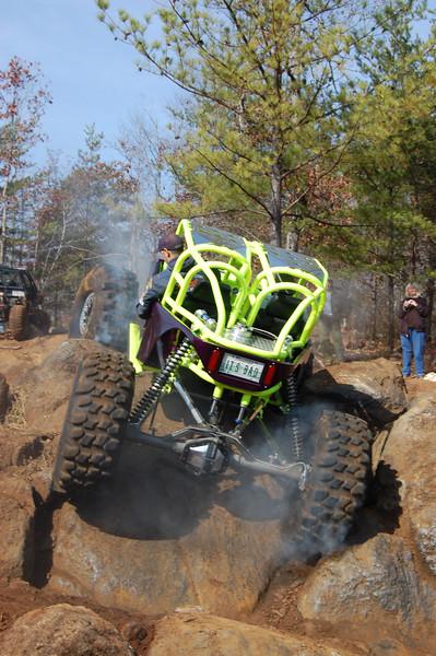

I need to figure out were to puts the rear bump stops...
Im not currently running the sway bar, and not sure if I will honestly at this point, but all things future considered and all that I got to go with.
Whats some thoughts on the matter ?
Im kinda thinking about building some landing pads on the top and going backwards off the axle tubes and having the cans come off the rear two down and forward bars on the chassis outboarded enough to clear the axle truss and back enough to leave room for the links on the sway bar...
first thought I get lookin at the pic and thinking about it.. thumb.gif :dunno:
I wont be seeing struts .... any time soon / ever laughing1
I think i can get them snuck in just behind the centerline of the axle and build off the top tube of the axle / gusset it underneath and back down the radius of the axle tube and be just fine..

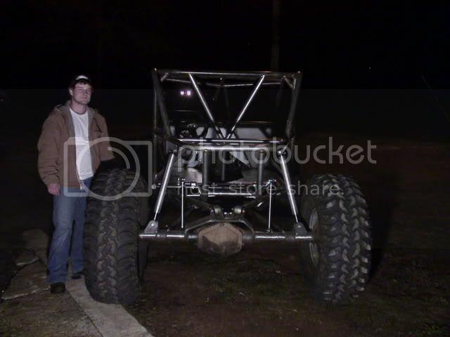

Heres a laid low pic I scrounged up... dont let the drunk bastard distract you laughing1
the sway bar links were / are mounted off tabs on the front side of the axle tube in these photo's BTW
You need a sway bar man! Get some longer attachment rods and rehook it back up.
Wait....are your airshocks that extended now?
I would hang the bumps down from the chassis, where the bottom out point on the airshocks and the airbumps are on the same plane. You will need to add some tube to drop and support them, but thats what needs to be done.
EDIT: Damn I type slow.
Yea, Ricky and Kelly. I was "holding" them in place and seeing were I had room for them and it looks like I have plenty of space to stick them basically out were Ricky photopainted them ...
Id like them to be outboarded as much as possible , but to keep everything in check the best spot is just outside the truss and building up off the top of the axle for a landing spot for them.
