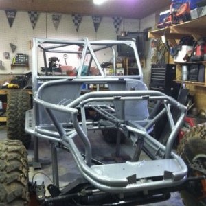

Connect a hose to the roll over valve on the cell and then do "three sides and down" route of the hose. Works great. The liquid will always have to run uphill to leak. If you make the hose the same as you supply line you will have a trail spare as well.

Adam Woodlee did four side around then down on Solo Buggy. He used the hydraulic hose the steering uses, as that is probably the most needed spare and all y ends are field installable.
When you guys say 3 or 4 side and down are you talking about running the hose up to the top of the cage and across the jeep and back down?
I just come up a couple inches the around the perimeter of the cell then down outside of the floor/chassis.
