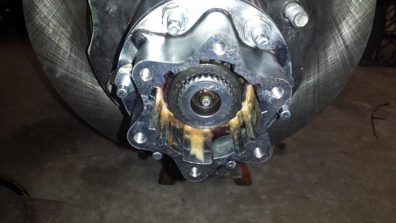

So whats the consensus on running the outer clip these days?
I know back in the day we did not run them when we did the martac.
My vag would run the clips as it keeps the axles centered in the trunions turning axis.
Letting the axle pull in and out of center is never good.
Plus it may help keep the locking hub from shooting into the bushes after the chinese studs bust off. :kissmyass::D
Run the clip
There are only 2 pins instead of the typical aftermarket 6 so when the Chinese studs sheer the hub body needs to be retained or it will go shooting across the woods never to be seen again.
I always ran the clips..Almost always. I definitely started using them after i almost lost a locking hub when the pins and studs sheared.
