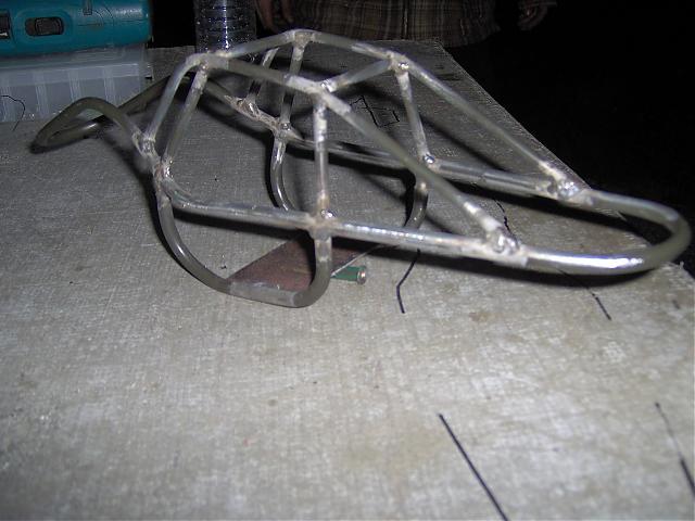

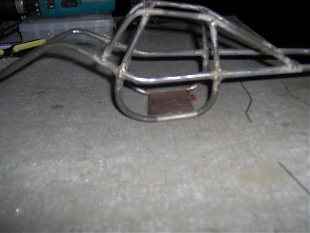

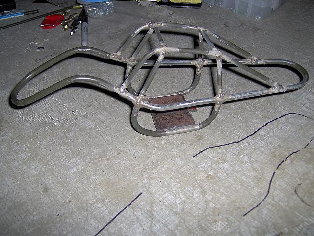

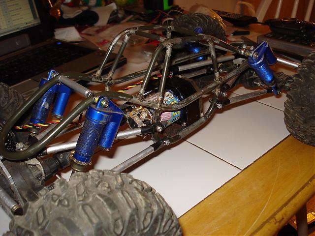

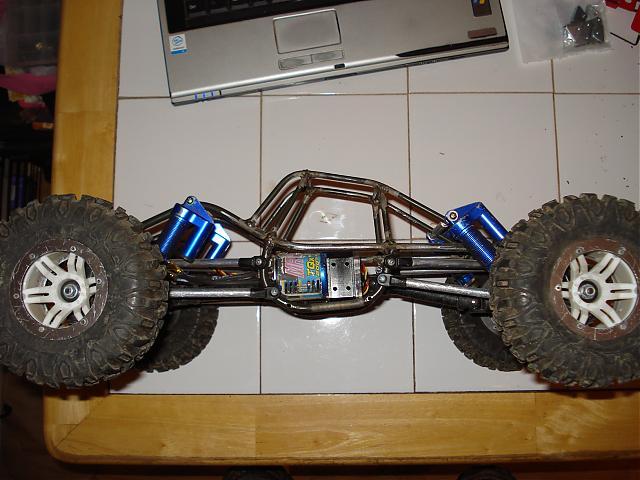

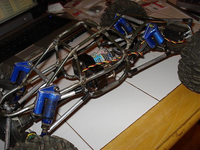

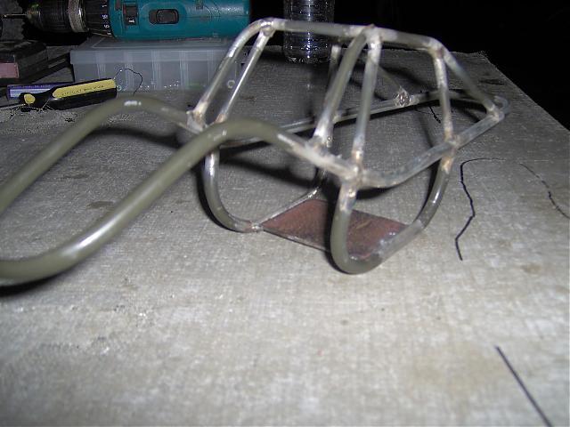

Been working on two chassis for a while now. One for me and a different one for Evergreen. This one is my new play design. I have a ways to go still. I have been reading Crash's latest build and Josh's tuber build and decided I need to get these two rigs back together. This weather is perfect for stayin inside.:redneck:
Some pics of the chassis. Its made from 3/16ths and 1/4 inch brakeline migwelded.

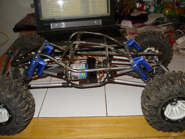

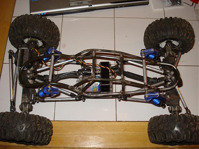

Mo pics of da machine:cool: Low as I can go!:haha:

I am going to try out the tlt axle brackets. I have ground through my last set of WK plastic axle brackets. I like thae fact the tlt ones are metal and I dont have to file and drill holes either!:redneck:
are the links mounted to holes through the frame? if that works it would make my life easier. i have to do some work on mine and wasn't sure if i was gonna use brake lines or solid stock. cool looking rig man.
solid stock is way heavy! Ive done it before on my super. Yes they are just holes in the lower section for links. the lower tubing is 1/4 inch. Ive done 6 different chassis this way with no failures.:beer:

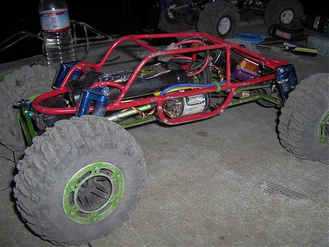

This was one I did for a friend with an axial. It was his design, kinda strange looking but still pretty cool.
I have one other one based off of axial drivetrain I am putting together right now.
The axial stuff is a little tricky its so narrow I spend a little bit of time getting the shocks right. Do you have aftermarket shocks? I like to build them to run short aluminum shocks with all droop or very little uptravel. Lipos or 6cell?
I do my tubers a little differently than store boughts. I hate radio gear/batteries on axles. A servo is all I can handle. No point in building a tuber that just looks like a battlebot.
