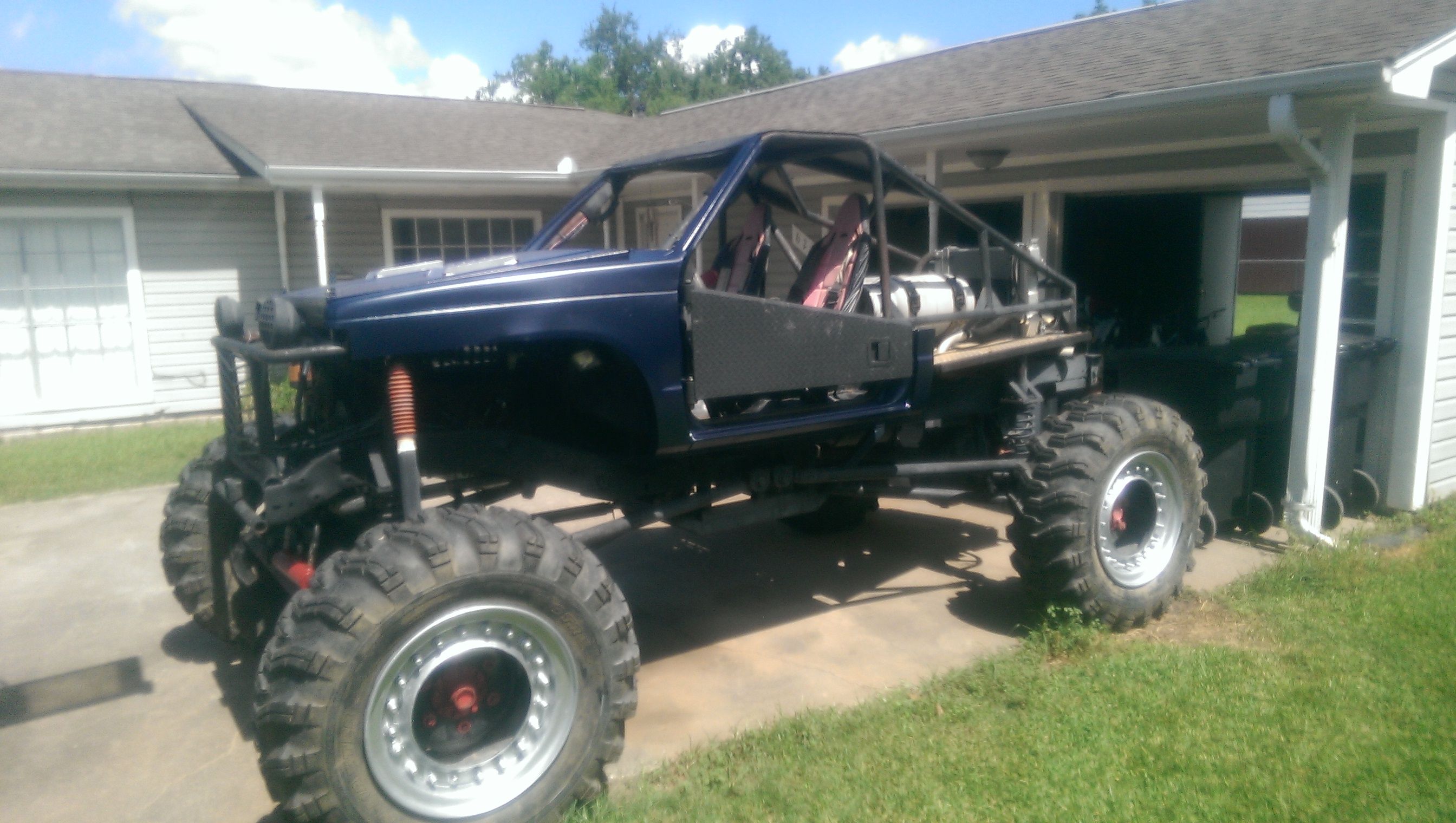

Ok I know that this is probably an old subject and that each rig is differnt but I'm trying to gather ideas as far valving and spring rate on coil over shocks that you guys are running. I'm mainly looking at running a pair of coil overs on my front end. My buggy is simple with a sbc, auto trans, t case on rockwell axles with 43's.
So give me your specs and opinions as to what setup might work good for my rig.
[/img]
I know I really need to weigh it but if I had to guess it's about 4500 lbs total and really close to equal weight front and rear, so ball park in at 1125 lbs per corner and most of the weight is down low with axles tires and wheels. Wish I had or knew someone close with corner scales so I could get an exact weight
