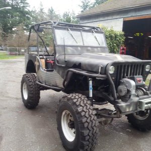

crawler 129 said:
Pics of buggy ?

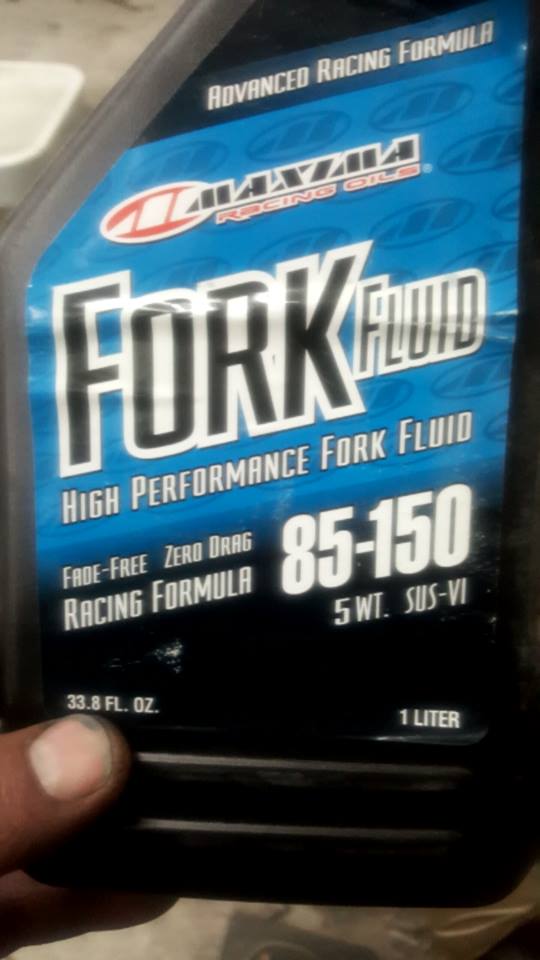

Go to your local 4 wheeler/ dirt bike shop and pick up some of this maxima fork oil.
