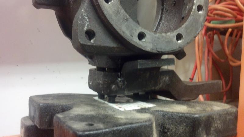

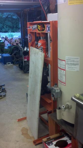

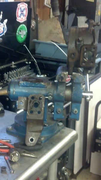

Bachelor for the weekend, so i thought I'd finally get my front axle torn apart and repaired.
Can't get the 4 cone washers loose in the hi-steer arms. I've had them sitting in penetrating oil for 3 days. Tried all the normal tricks, hit them with a acetylene torch to get them warm. Nothing.
Was able to drill 4 or 5 holes in one and get it out. The other 3 still aren't moving.
Hate cone washers... :mad:
Do you always have to do things the hard way? :fawkdancesmiley:
I'm not sure why one of you ass-hats didn't tell me to use a press and press the arm off. :fawkdancesmiley:
Not sure why I didn't think of it sooner.
I was a bit scared, still have the cast HF arbor plates. I need to cut some steel for new ones.
It's apart now. This press has paid for itself several times.
