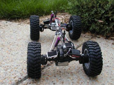

i actually have a homebuilt stick, im not using it anymore either. maybe i can work a trade with ya.. all it is is the backbone.. 2 heims, mounting plates, and shock towers. let me know. I am currently building a tuber and I need some little things here and there.

Got the stick chassi at my house now. The links that were on it were 6" or so. worked really well with the max shocks that were on it. anyway man, consider it yours with all the plates and heims.
