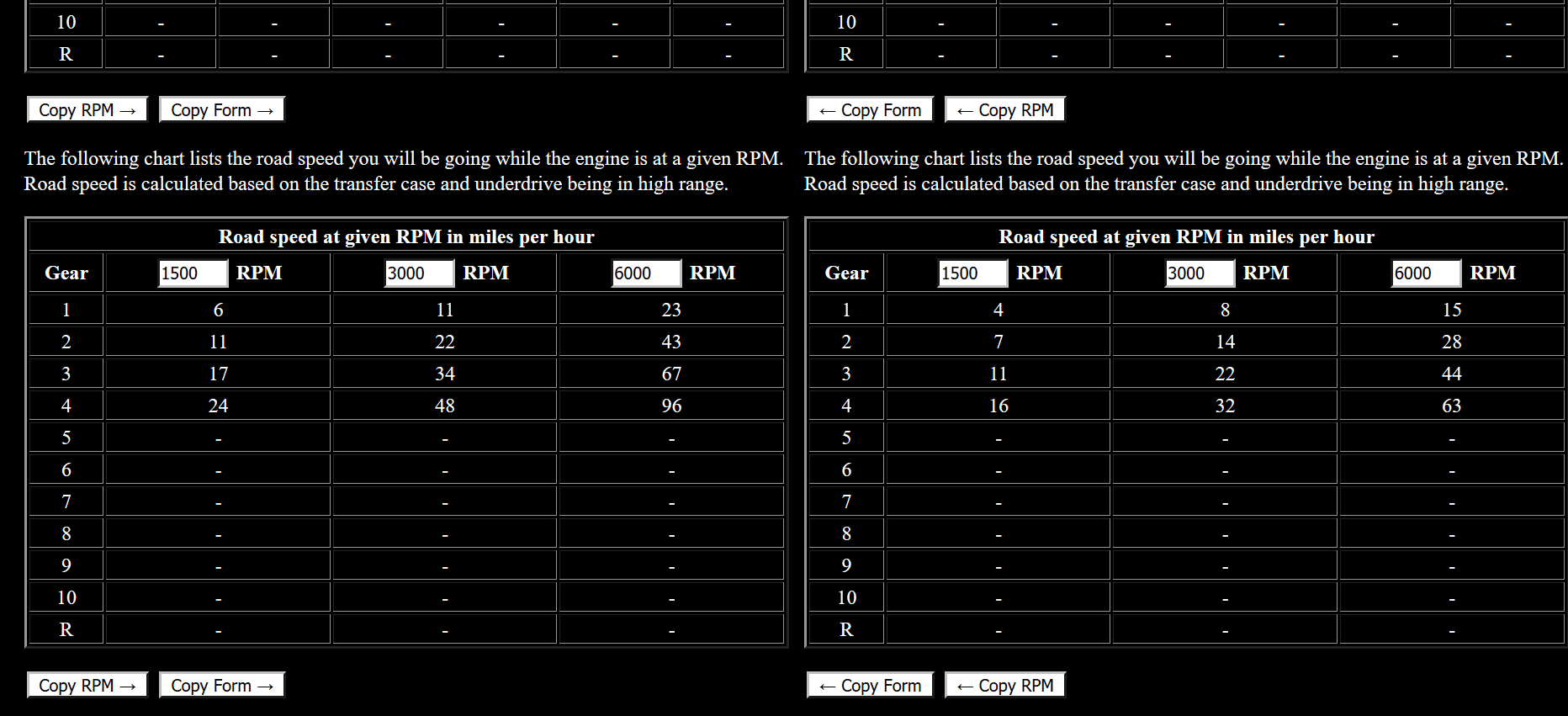

Go here and enter the all the numbers. (http://www.grimmjeeper.com/gears.html)
I entered the numbers you gave above and took a screen shot of the mph vs engine rpm vs gear.
3.54 ratio on the left 5.38 on the right
That's a sweet chart. I really think the 5:38 would be best. It gives a decent crawl ratio especially with a good power to weight ratio.
