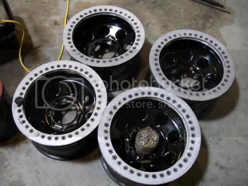

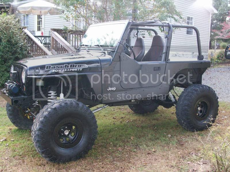

Can't wait to get this thing back and on the trails, finished build is 116 WB, 4 linked front and rear, 1 1/4 lower, 7/8 upper heims, Stak Monster Box 3 speed, Rubicon Express skid, 40" LTBs on 32 bolt 17" beadlocks (thanks Bob) 14" Fox air shox on rear, 16's in front, Mastercraft Rubicon suspension seats, D70 rear and D60 front, high steer with full hydro steer

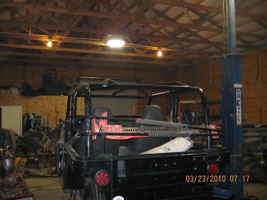

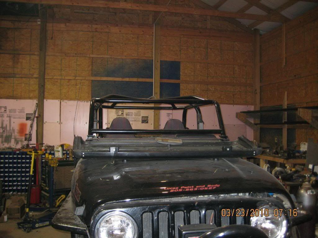

looks nice! only thing that bothers me is that cage.....after seeing that TJ endo last year at the SETTC and completely destroying the cage and the rest of the rig, not sure I would want one like that. The cage did do its job, it kept the driver safe, good thing a passenger wasnt with him though. it completely folded those A pillar plates on impact and the cage layed over. not trying to be an ass about it, just a precaution. I will have to try and find some pics later on today.
Brian
Brian
I appreciate the input, the cage isn't done yet, still have to add more to the front and rear and tie it to the frame, we also plan to connect the A pillars under the dash and they are made twice as thick as the kits you order, once again I appreciate the advice and that may be something to look into as we continue the built

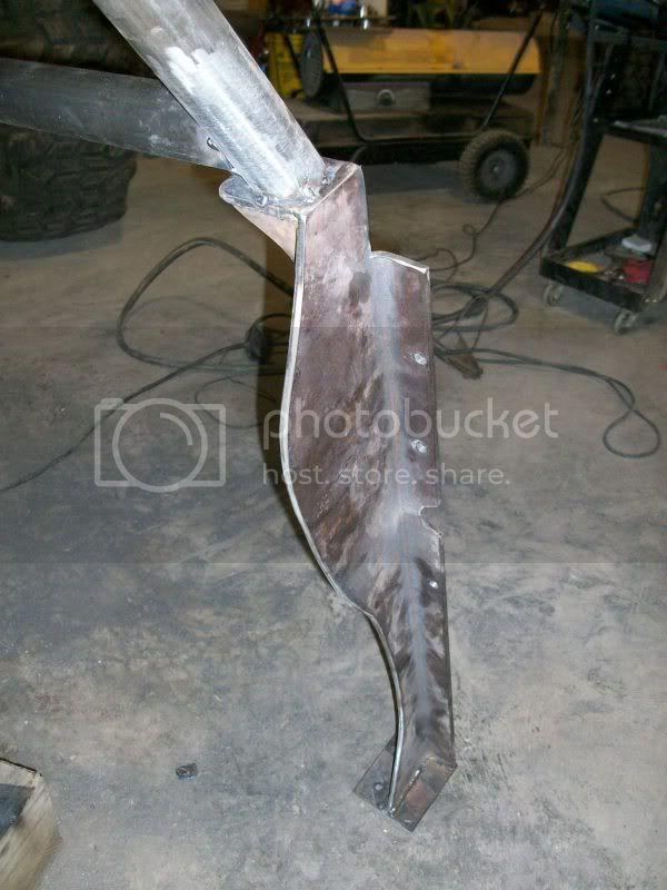

The staunches collasping is no worry to me that's the reason I build my own and not buy prefabed mine r 5/16 thick cols folded and guseted so no worries on cage failed

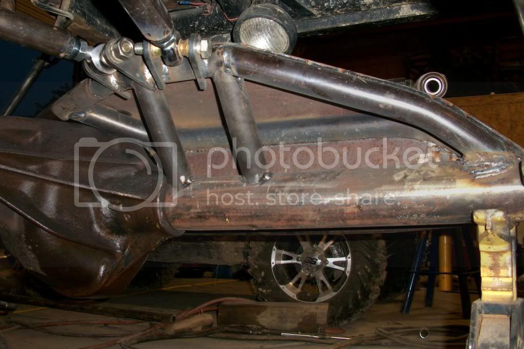

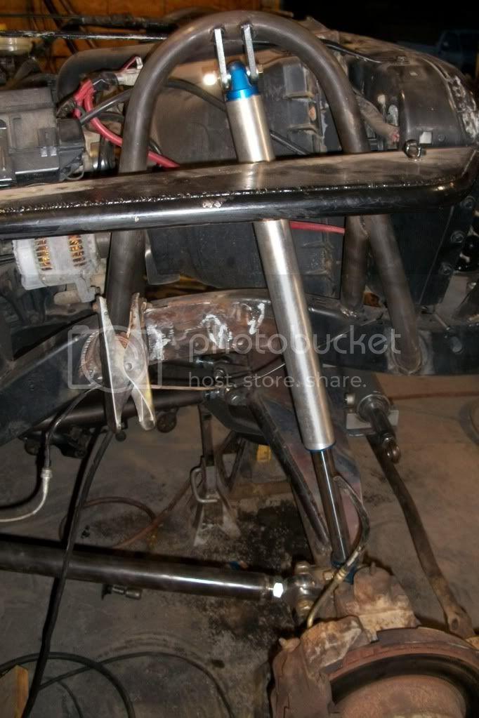

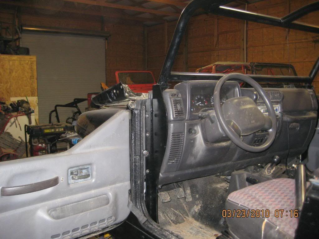

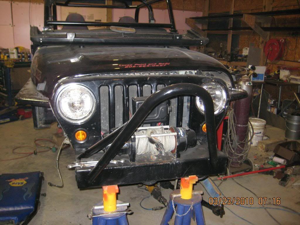

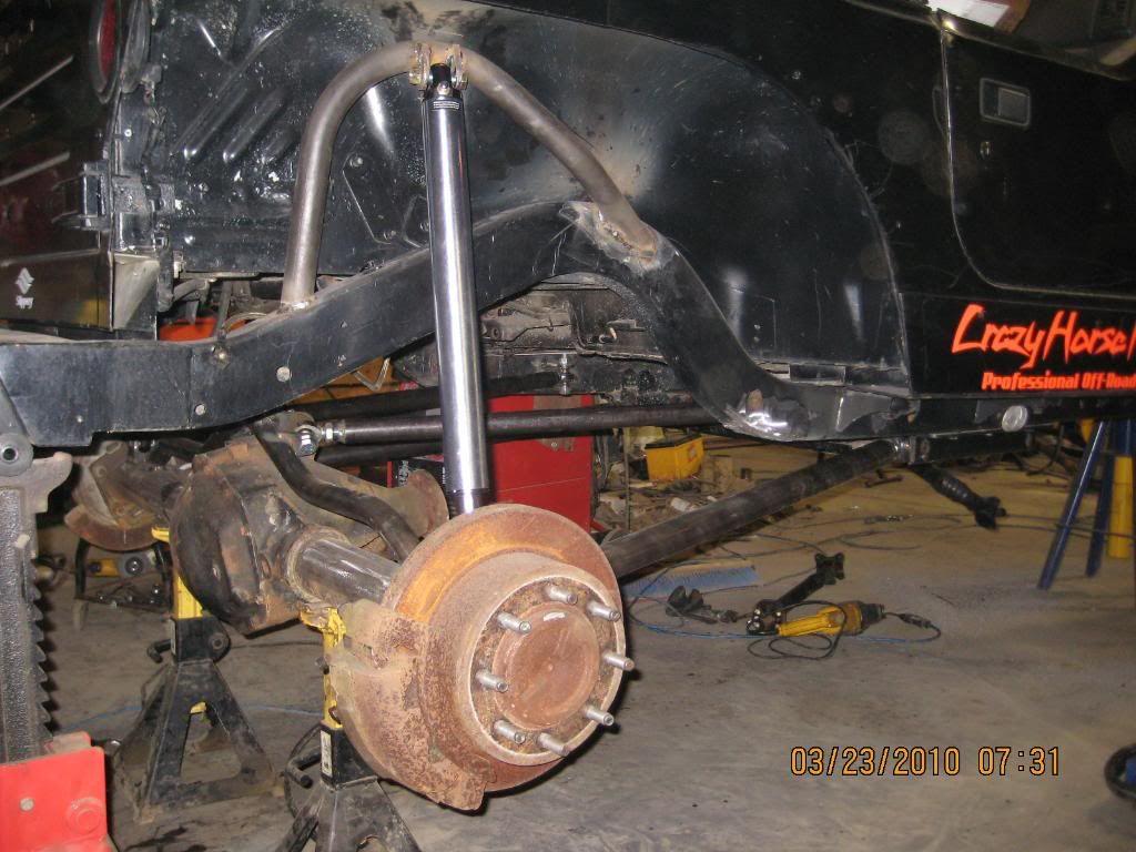

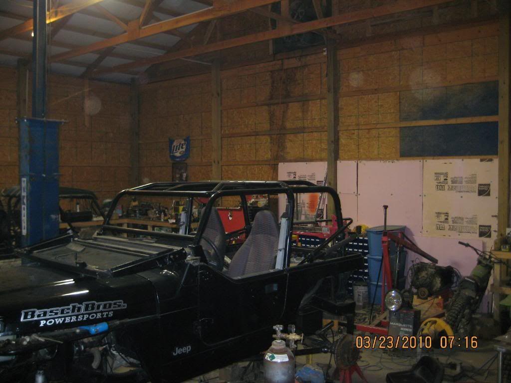

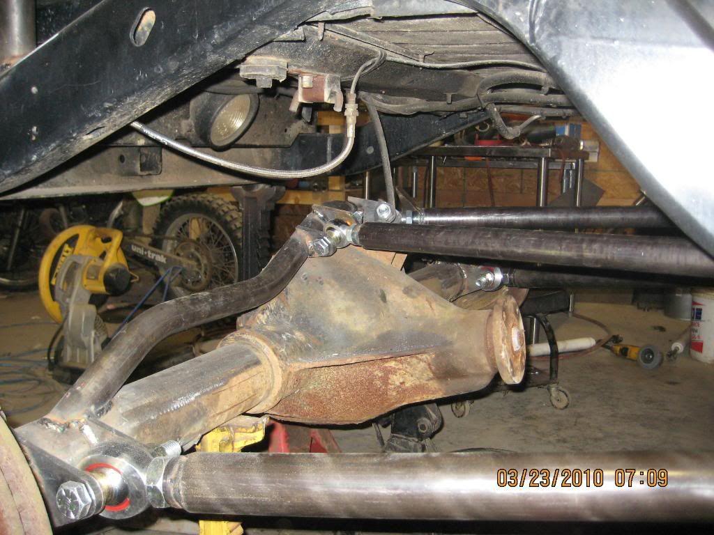

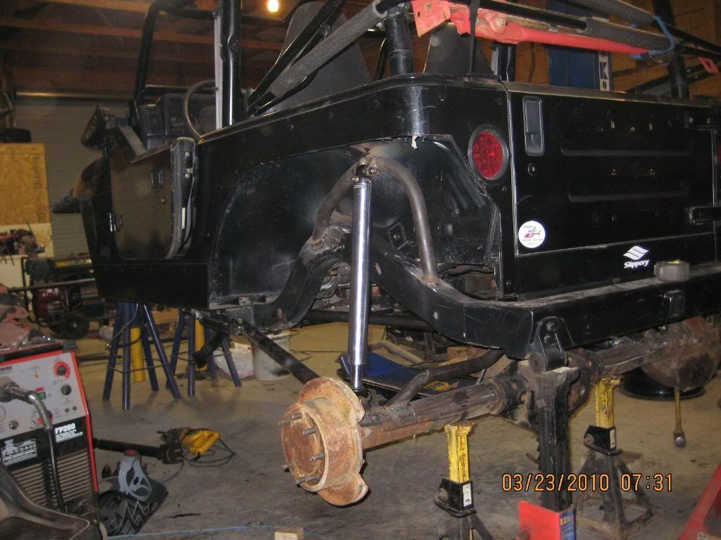

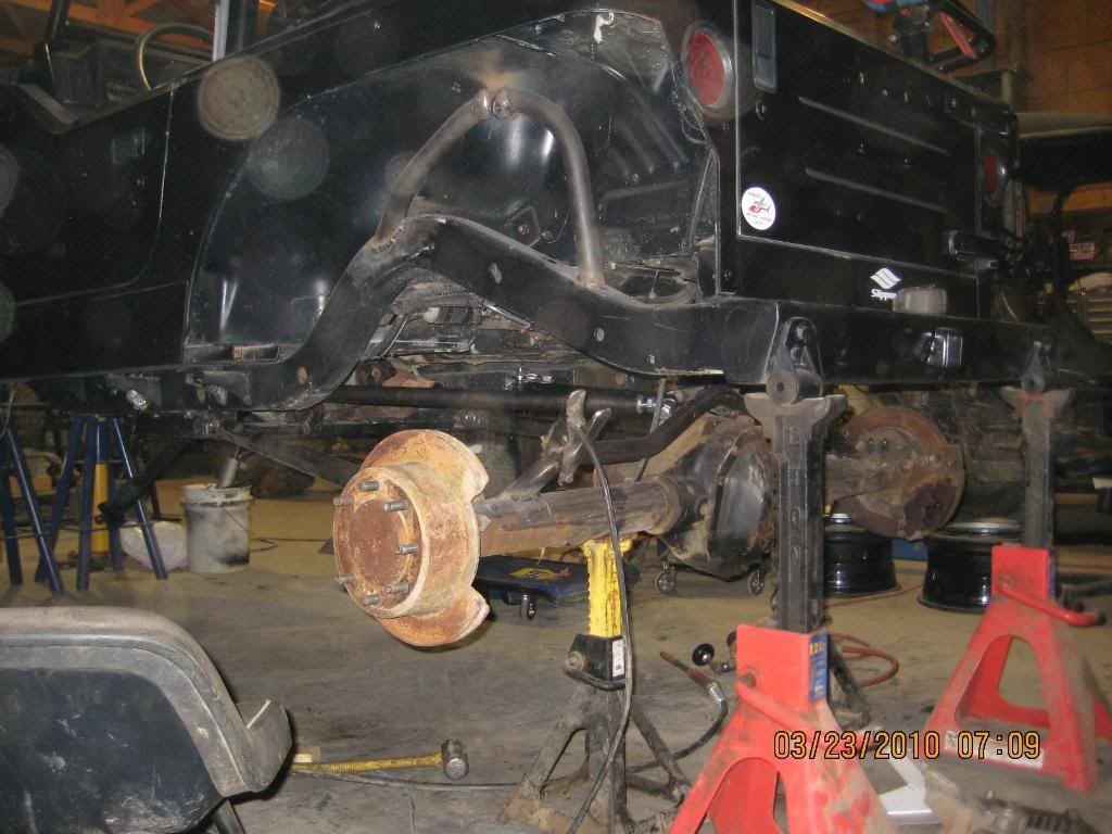

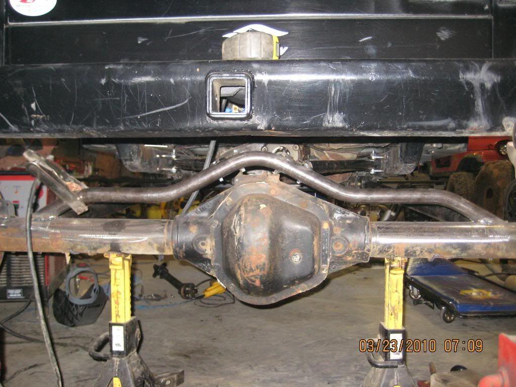

Here are a few pics of the TJ at the start and some of the parts and fab, going quick and smooth
Cage under way and stinger

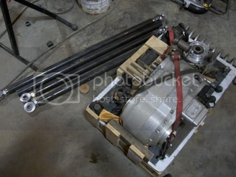

A few parts...

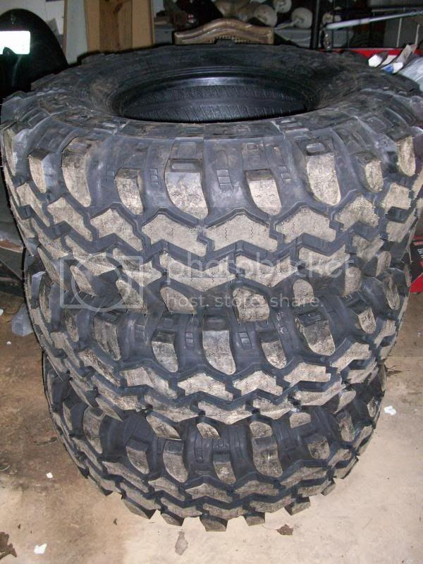

LOL, trying to trade my tires for some Krawlers, I prefer the crawling side of the sport, can't afford the racing side :****: Ready to hit the rocks with it though

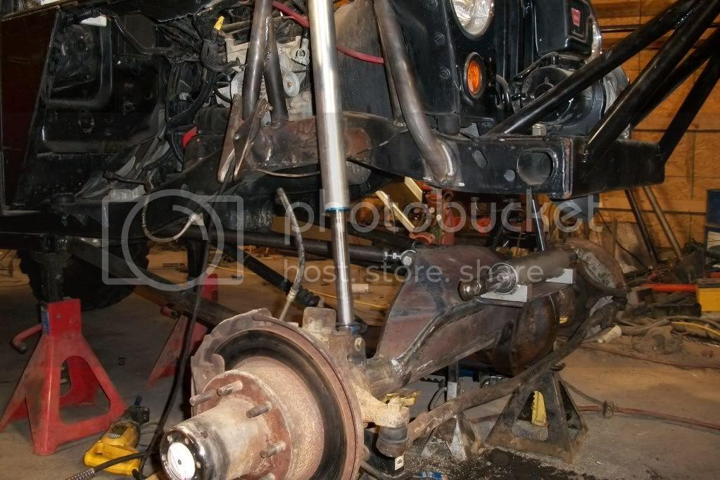

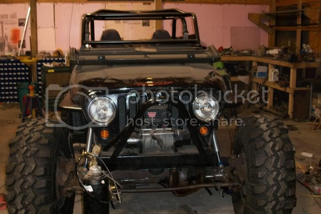

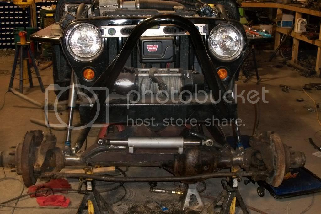

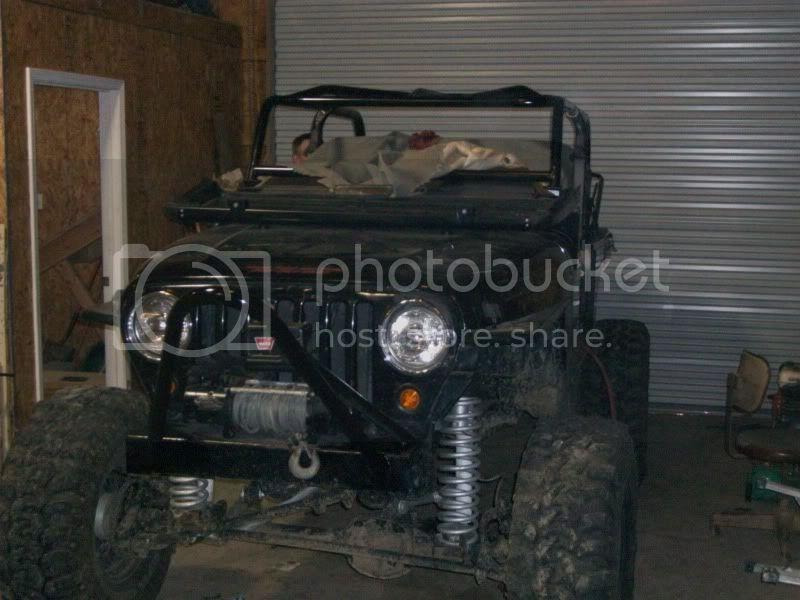

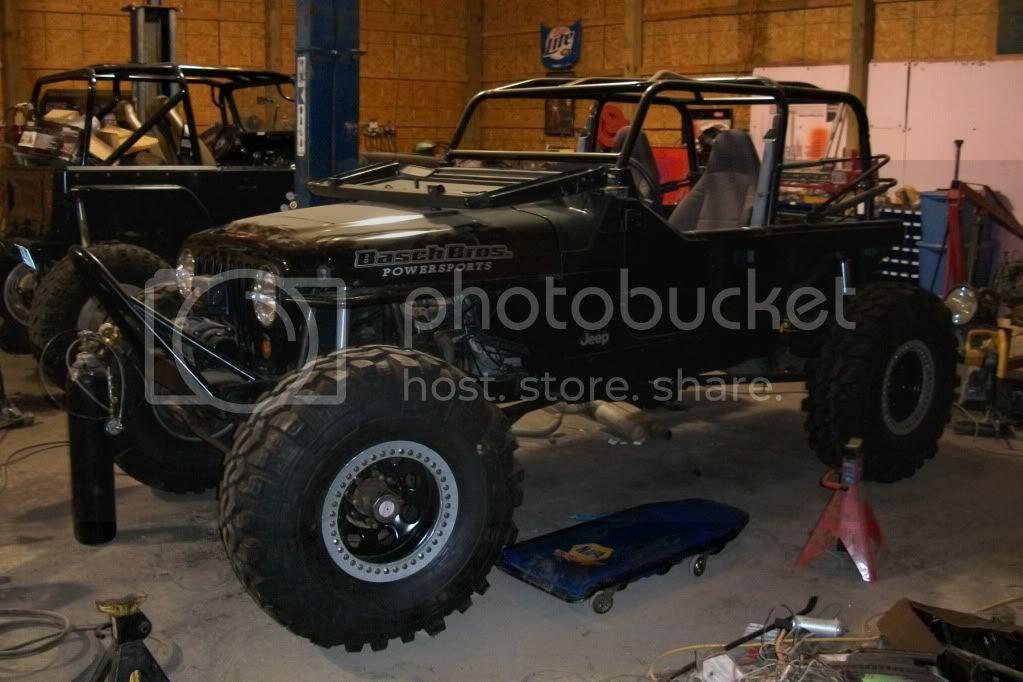

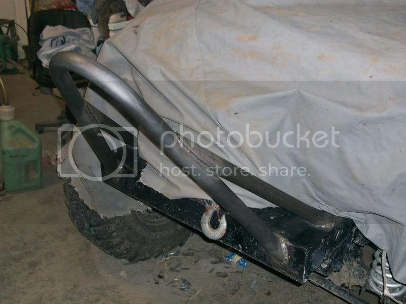

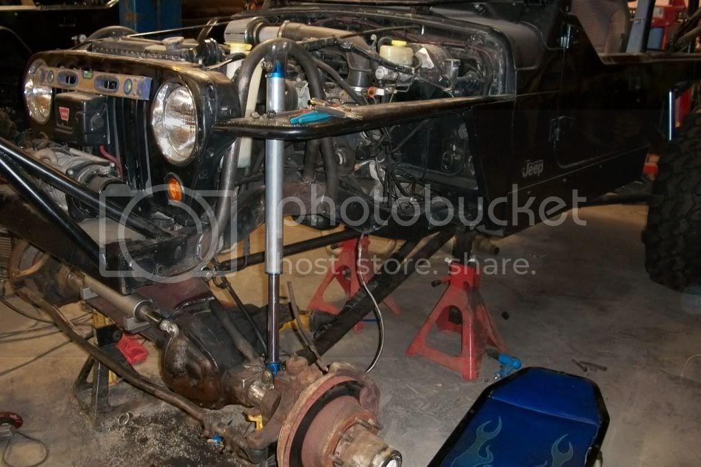

Headed over last night and we got it on the ground for the first time in a few weeks, here are a few pics as of last night, I am really pleased with the work and effort Gary has put into this build, front truss is SICK, air bumps, high steer and gears should be in this week, booyang
Appreciate it, that was the whole goal to get it as low as we could, it will sit about 2 inches higher with the shock nitro level set and the belly will be right around 25" of clearance
I appreciate it man, Garys put alot of hours into it and hopefully we should be getting close, Memorial day is probably out of the picture now, I have added some more stuff :dblthumb:
