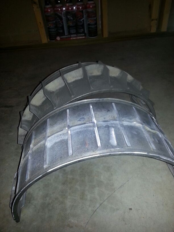

For a cheap & lightweight option just cut down the stock mag. run-flats. Knock the side "fins" off with a hammer, use a sawzall with a wood blade to cut the center ridge, and smooth everything out with a flap wheel.
They only weight a few pounds each once cut down & are still plenty strong.
Only took me a couple of hours to cut down (5) complete run flats.

I did the same and cut the mag inserts down and smoothed them out, I wouldn't have thought they'd weighed a couple pounds at the most, not to mention CHEAP.

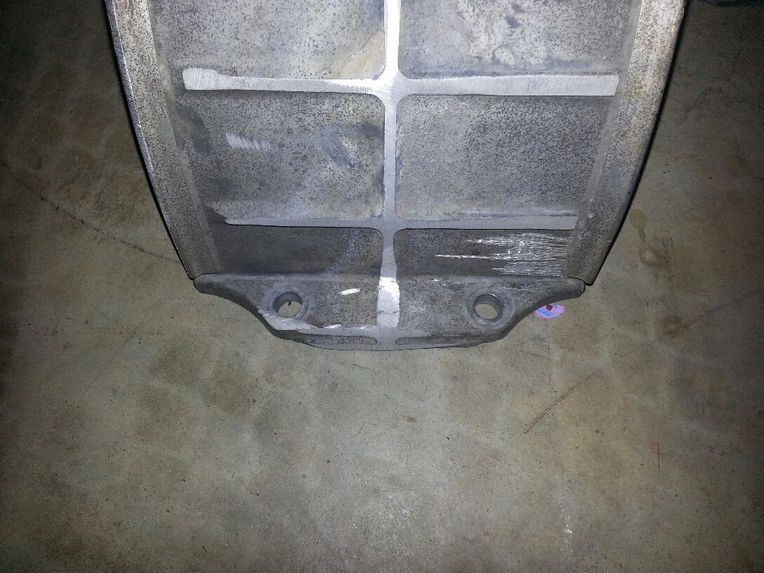

The picture is the "flange" that bolts that halves together.
Also measured the OD of the inner shell of my wheels at ~15.75". I would say you would need pipe with a 16" ID at a minimum.

What is the purpose of cutting off the fins? By cutting off the fins but leaving the flanges, you surely aren't going to use it as a true runflat, correct? That would give you two spots that would make your rig jump ;D
You have to cut the "run-flat" portion of the insert off so it does not damage your tires when you are aired down on the trails. You are correct that it is no longer a run-flat. Its now just an insert that locks the bead of the tire to the wheel.
Got to leave the flanges so you can bolt the halves back together.
I saved all of the pieces I cut off for some camp fire fun ;D

These are cut down mag. runflats.
