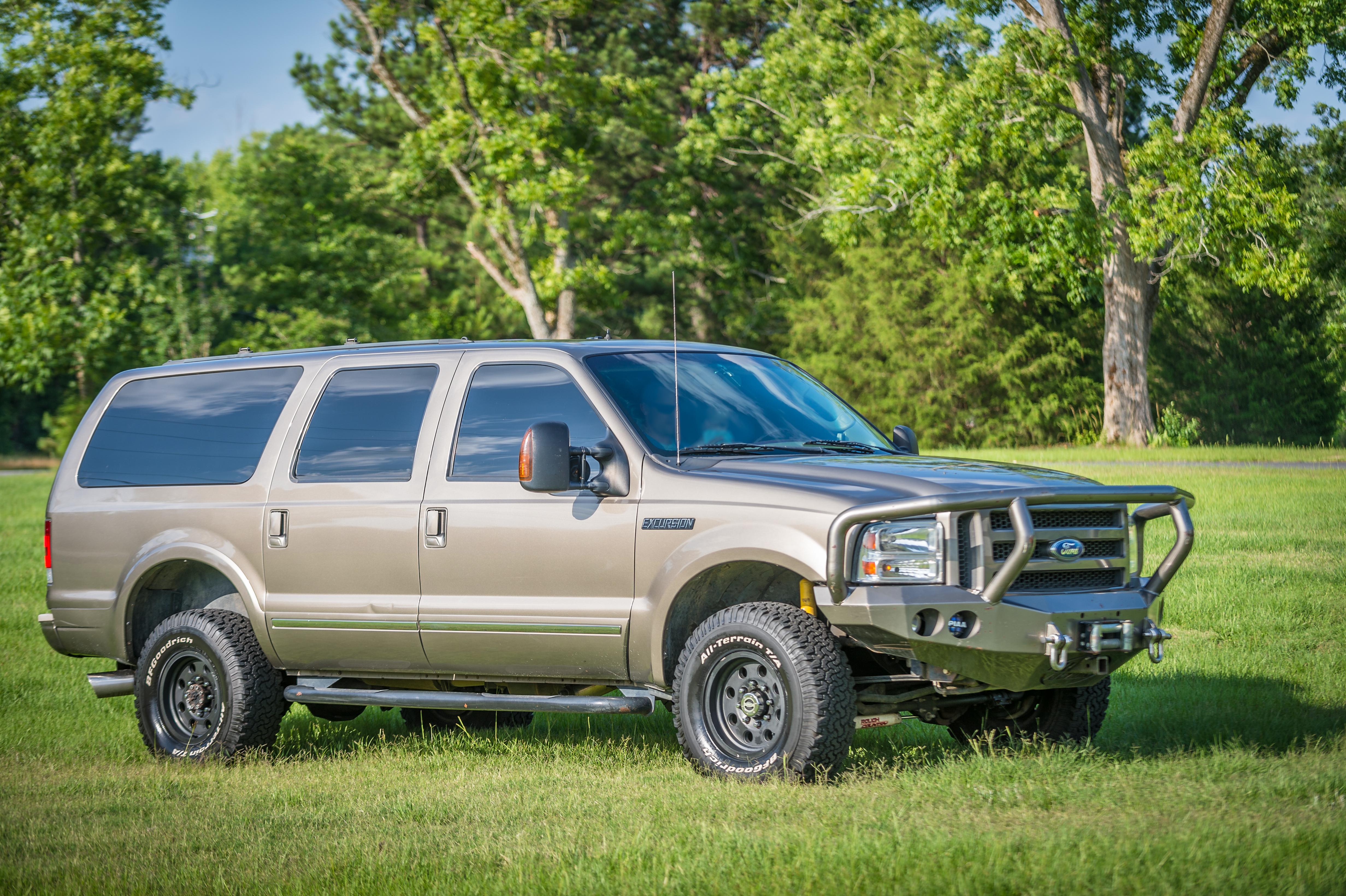

Well since the Excursion is rumored to be making a comeback we figured we would build one.

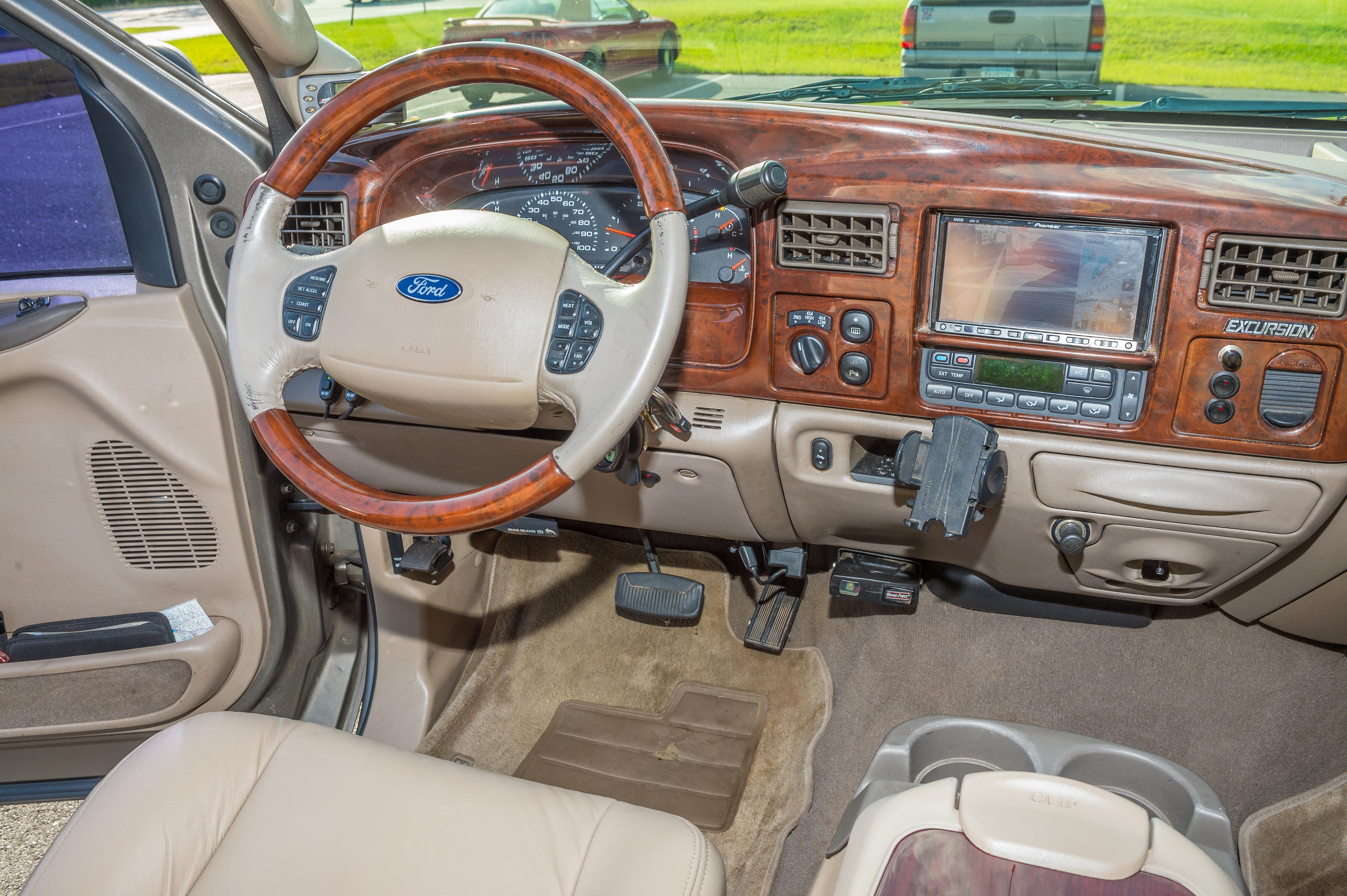

another great mod is the factory wood steering wheel. Will never wear out like the leather ones
JL audio makes a AWESOME front center console stealth box subwoofer. It's bad ass and does not take up any rear cargo space. Bass up front is better than waaaay in the back.

We are thinking Super 60 swap with coil springs and radius arms for suspension and enough clearance to run 37s.
It's also supposed to make for a tighter turning radius.
This is a solid plan that I'm considering the same. The larger unit bearing is a huge benefit as well.
