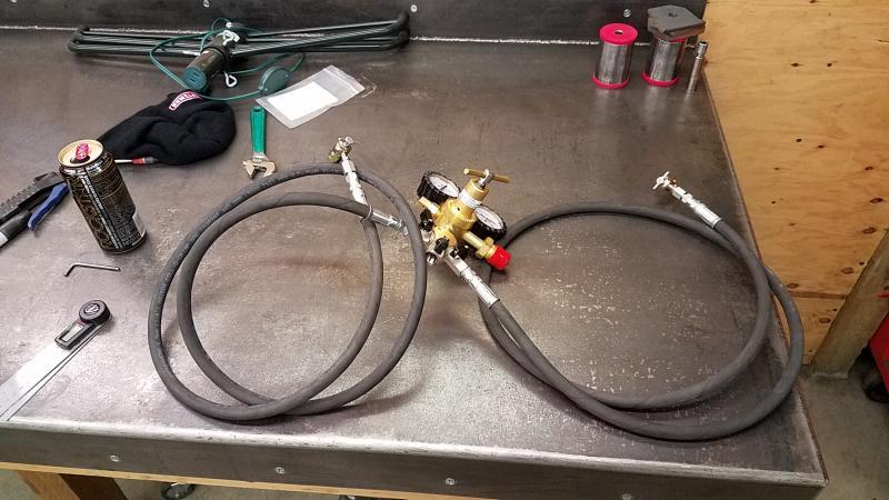

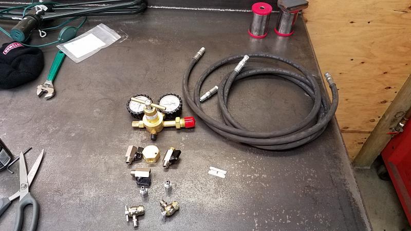

So had been researching getting my own nitro fill setup and boardbysled had mentioned a thread on pirate. Figured I would share here and going to get parts ordered today and get it setup..
Uniweld RHP800 Nitrogen Regulator with 0-800 PSI Delivery Pressure
https://www.amazon.com/Uniweld-RHP8...ds=Uniweld+RHP800&refinements=p_85:2470955011
Coilhose Pneumatics 3122 Flat Hex Manifold
https://www.amazon.com/gp/product/B...n?ie=UTF8&psc=1&tag=vs-auto-convert-amazon-20
Kingston KMBVM Series Brass Mini Ball Valve (Will need 3)
Aircraft Tool Supply Schrader High Pressure Strut Coupler(Will need 2)
https://www.amazon.com/Aircraft-Too...l+Supply+Schrader+High+Pressure+Strut+Coupler
And 2 hydraulic hoses whatever length ya want with 1/4" male on one end and 1/4" female on the other. The only thing I need to see is how to make the female end swivel.
Will post updates once I get the parts in hand :awesomework:
I got 2 hoses made 6ft long which completed my needed parts.

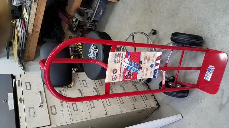

I also picked this up and will modify it once I get the tank so its mobile...
