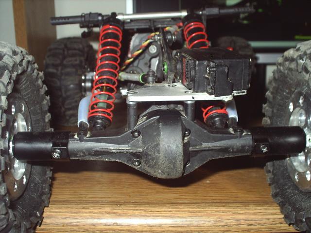

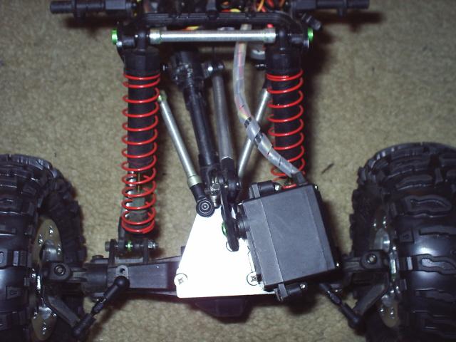

hey Brian i've got a driveline disconnect you can have all you need to supply is a servo.thats the driveline, the shaft and the servo mount ... I won't need it after this weekend. I should have my VF dig, (got in on the early buy ,one of the very first to order it...) you can have the old stuff i've got, its a disconnect but not a lock...
